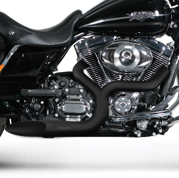

Pretty sure these are going to break the decibel level meter. Got them and just waiting for my build to complete.
