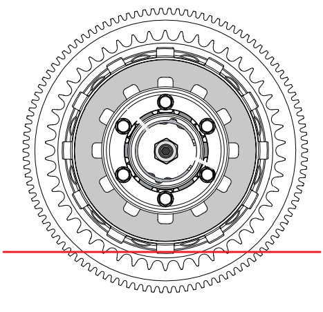

The only reason you need to know how much lube the primary takes is so you know how much to have on hand...
What you really need to know is what the proper level is, because knowing how much it takes doesn`t help you one bit if for some reason you need to check the level...
It should be filled so the level is just touching the clutch outer shell with the bike upright.
Stop worrying about whether it takes 38 oz or 38.0001 oz.

Because on my 99 I had a inspection cover, I did not have to have the bike upright to change or fill my primary, still wish they had inspection covers....
Anyway, I got it, fluid upright is touching the bottom of the clutch.
