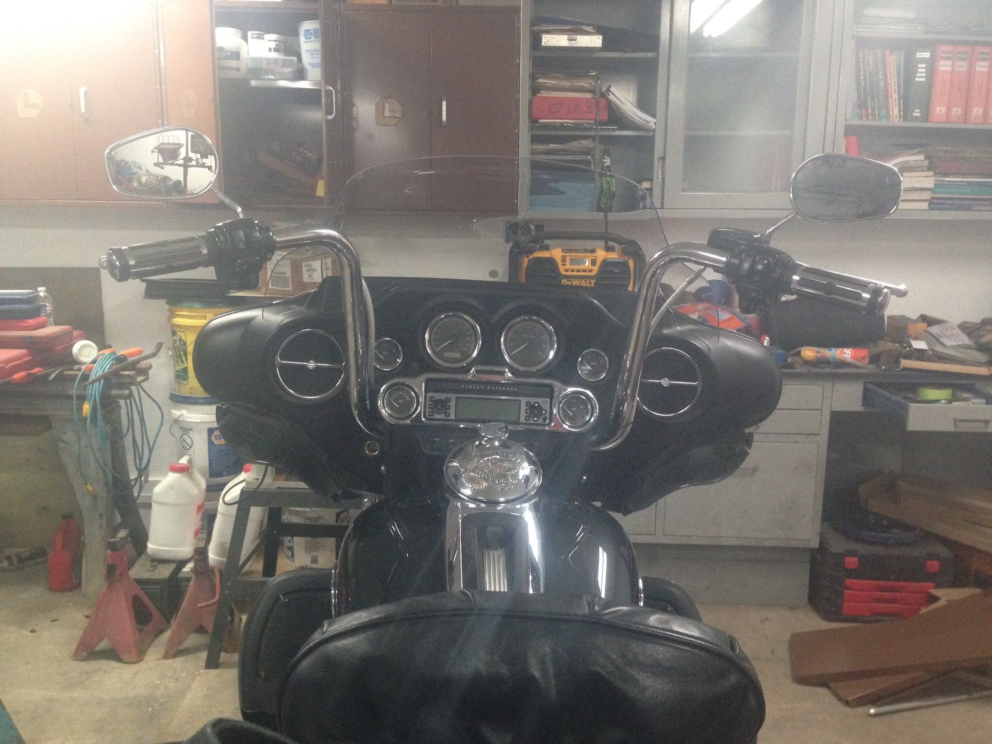

I went with the 14s on my 08, had to put on new cable, brake line and extend all the wires. Well worth it for me.
