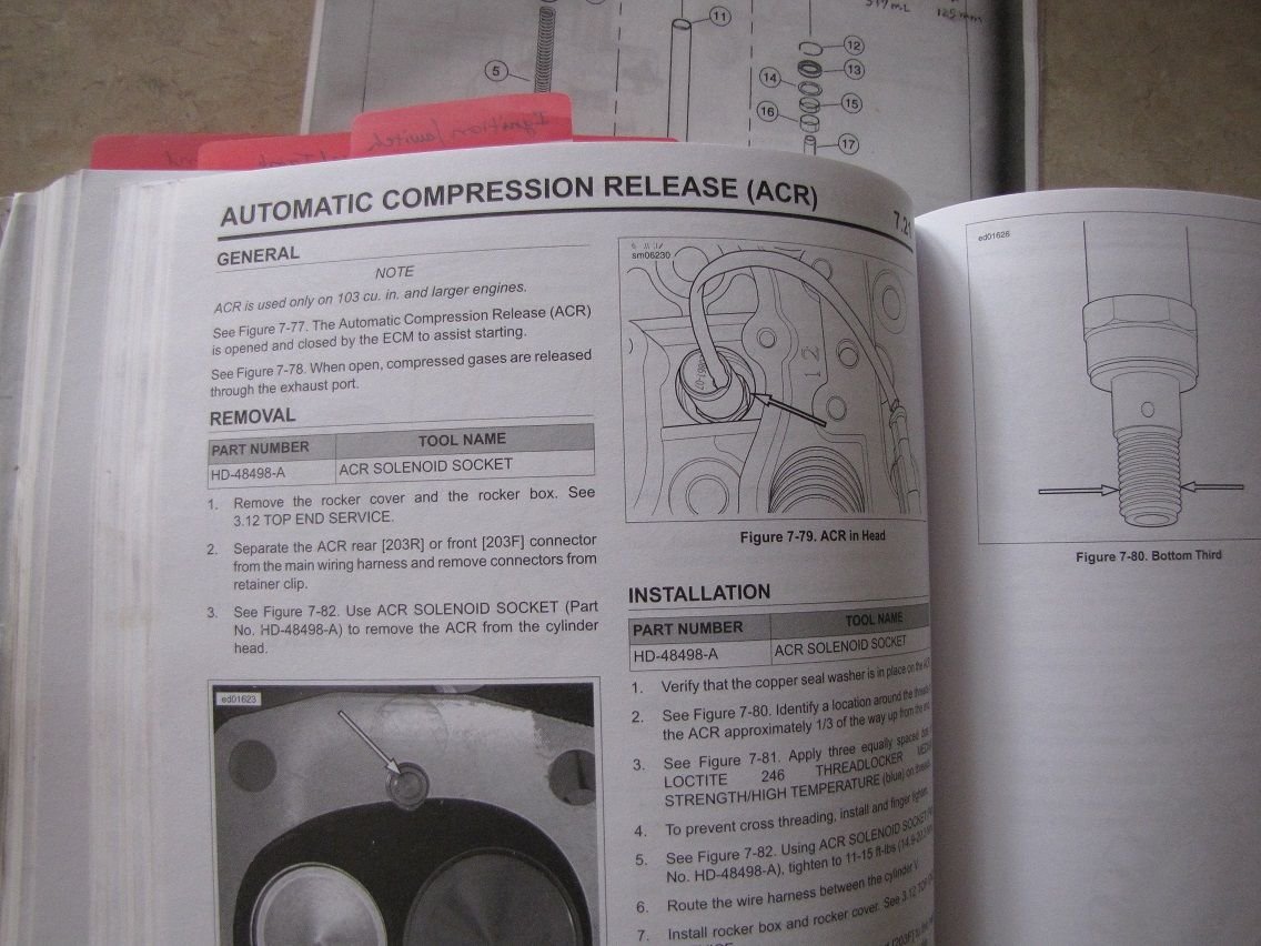

The question about the Comp. Release was for Buelligan666.
Here's a page from the service manual that explains the ACR.

No, my Electra has no ACRs. I verified that last year.
