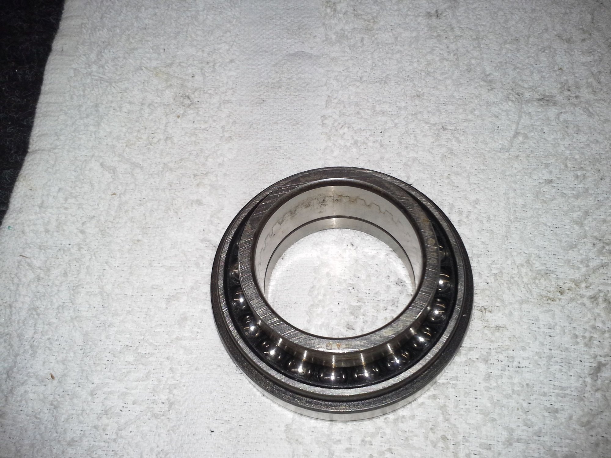

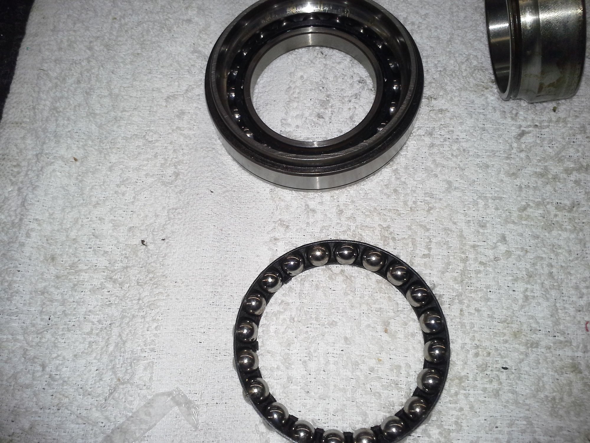

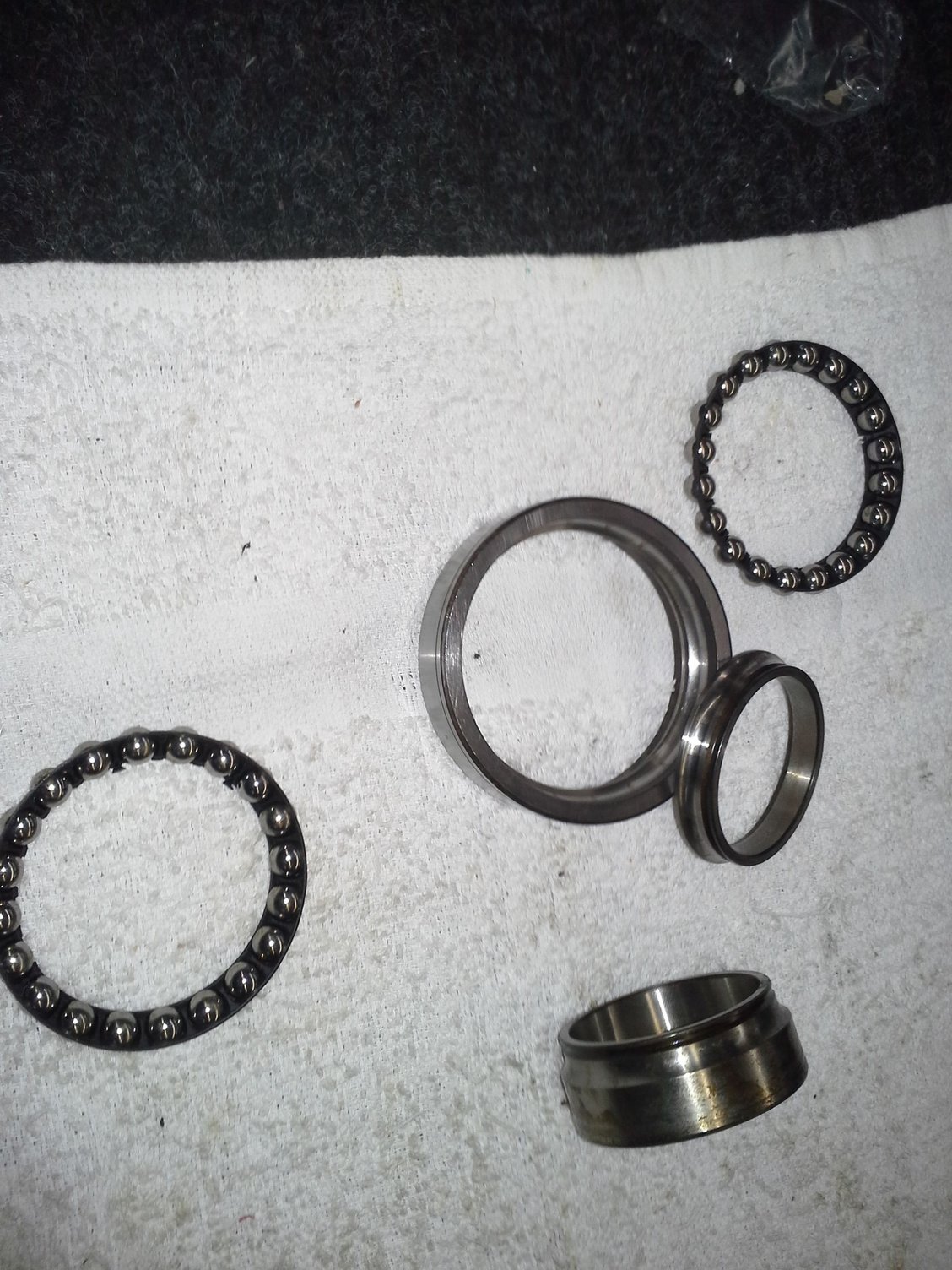

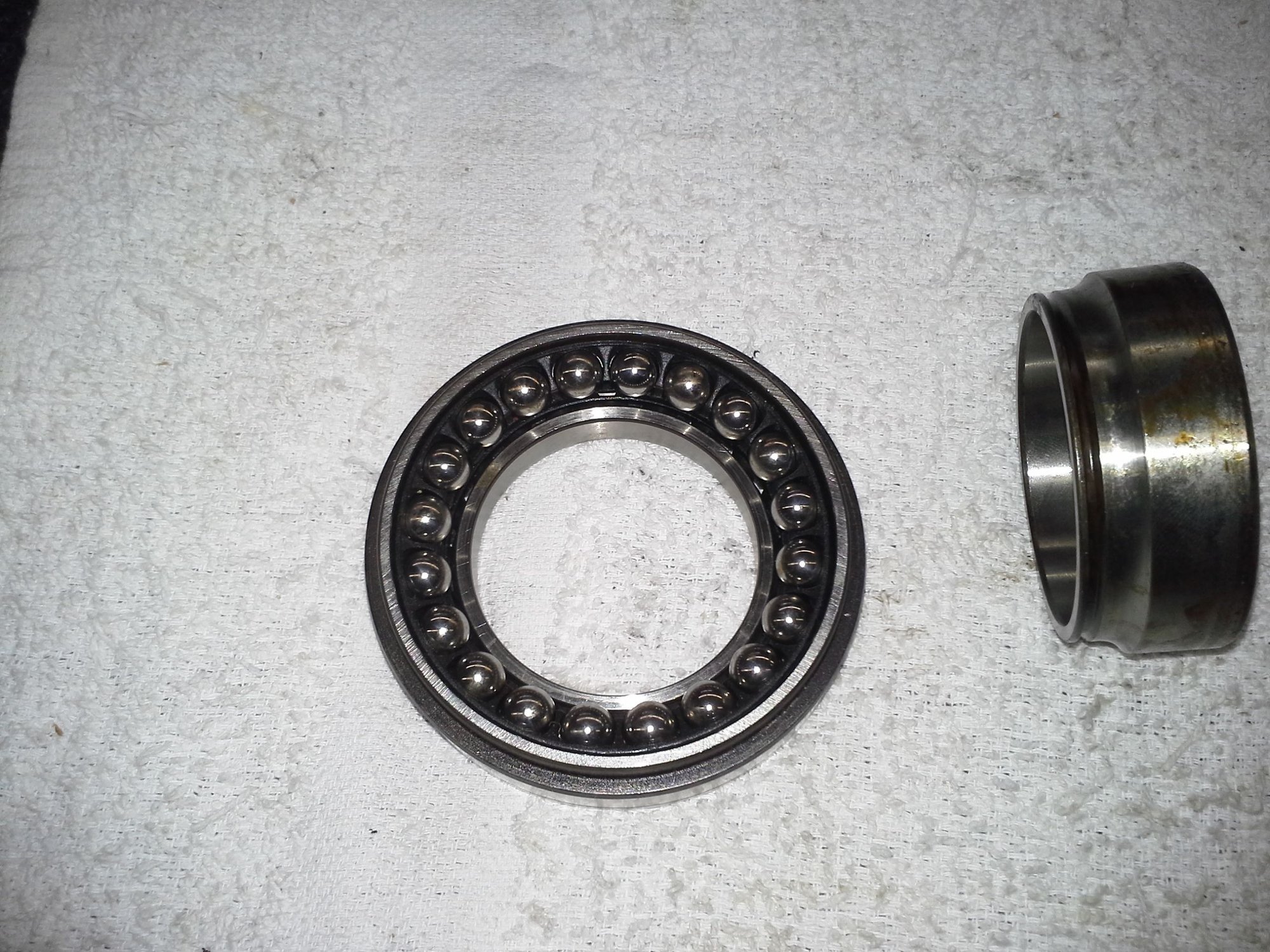

Poor bearing design for starters. It is a double row bearing with 2 separate races. Helical cut gears cause a condition known as axial thrust which means the the mainshaft and counter shaft are forced away from each other. Harley retains their door bearings with snap rings that are insufficient in keep the shafts in place which puts undo stress on the main drive gear and the inner race of the bearing. The inner race heats up melts the plastic bearing cage and then the ***** go every where. I'll snap some photos to show you the bearing design.

[QUOTE=Mark@ Baker Drivetrain;14164066]Poor bearing design for starters. It is a double row bearing with 2 separate races. Helical cut gears cause a condition known as axial thrust which means the the mainshaft and counter shaft are forced away from each other. Harley retains their door bearings with snap rings that are insufficient in keep the shafts in place which puts undo stress on the main drive gear and the inner race of the bearing. The inner race heats up melts the plastic bearing cage and then the ***** go every where. I'll snap some photos to show you the bearing design.[/QUOTE
Thanks for the input and the photos...
