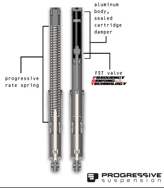

Originally Posted by Bikerscum
The premium cartridge forks are the same way. But then, so are Progressives so I guess it works.
You referring to Progressive monotubes? They have 2 gas charged "shocks" that replace the internals of the forks.
Old Jul 6, 2015 | 06:11 AM
Hammz's Avatar
Hammz
Joined: Sep 2013
Posts: 3,820
Likes: 588
From: Michigan
No, only one gas charged tube. The other is a progressive wound spring.
