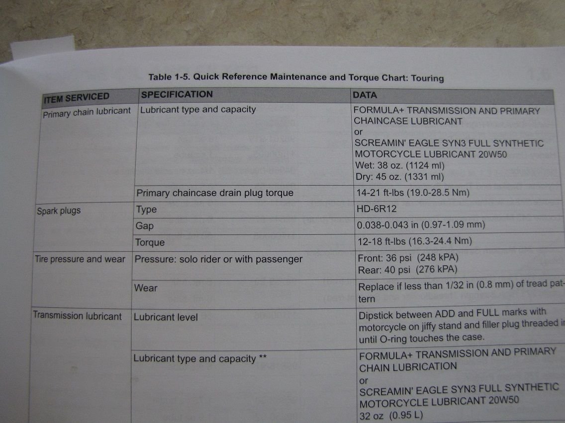

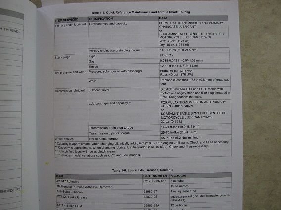

If I remember correctly if you pull the entire housing and not just the inspection cover it is 45 ounces instead of 32

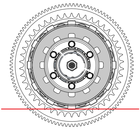

You mentioned bottom of the basket. This is where you should fill to, bottom of the spring. I don't have a 2005 manual but 2011 and 12 and 15 manuals all say 45oz for dry and 32oz for wet. Dry is when you take the case off, like you did and wet is just drain and fill at the inspection cover.

Thanks Vernal! Yeah... that's about where I'm at looking through the derby cover. And that was after pouring in the 2 quarts! Now just to be clear, I removed the entire inner and outer primary, compensator, clutch, primary chain etc.

That's what they call dry, no oil left in the bottom of the case. Should only take 45 oz's.

If that's where your oil level is with the bike standing up then your over full. That's the full mark on the jiffy stand.
