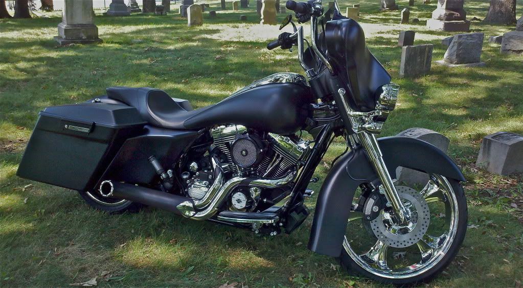

this is the bike that started my interest in the 23". you said in this picture it had stock trees right?
Yes, stock trees in this picture. Had it over 100 and put a few hundred miles on it like this before putting the HHI trees on. Running progressive monotubes lowered 1" and 944's for rear shocks. The weight and responsiveness with stock trees at low speed was insane and very light but I did notice it was not as forgiving at higher speeds meaning, I felt every ripple and uneven surface. With the HHI I noticed it was still responsive at slower speeds but closer to stock at 80+ in how I feel the road. I have been out this past week, so I am hoping to put more time in the seat this coming week to get a better feel for the HHI trees at highway speeds.
