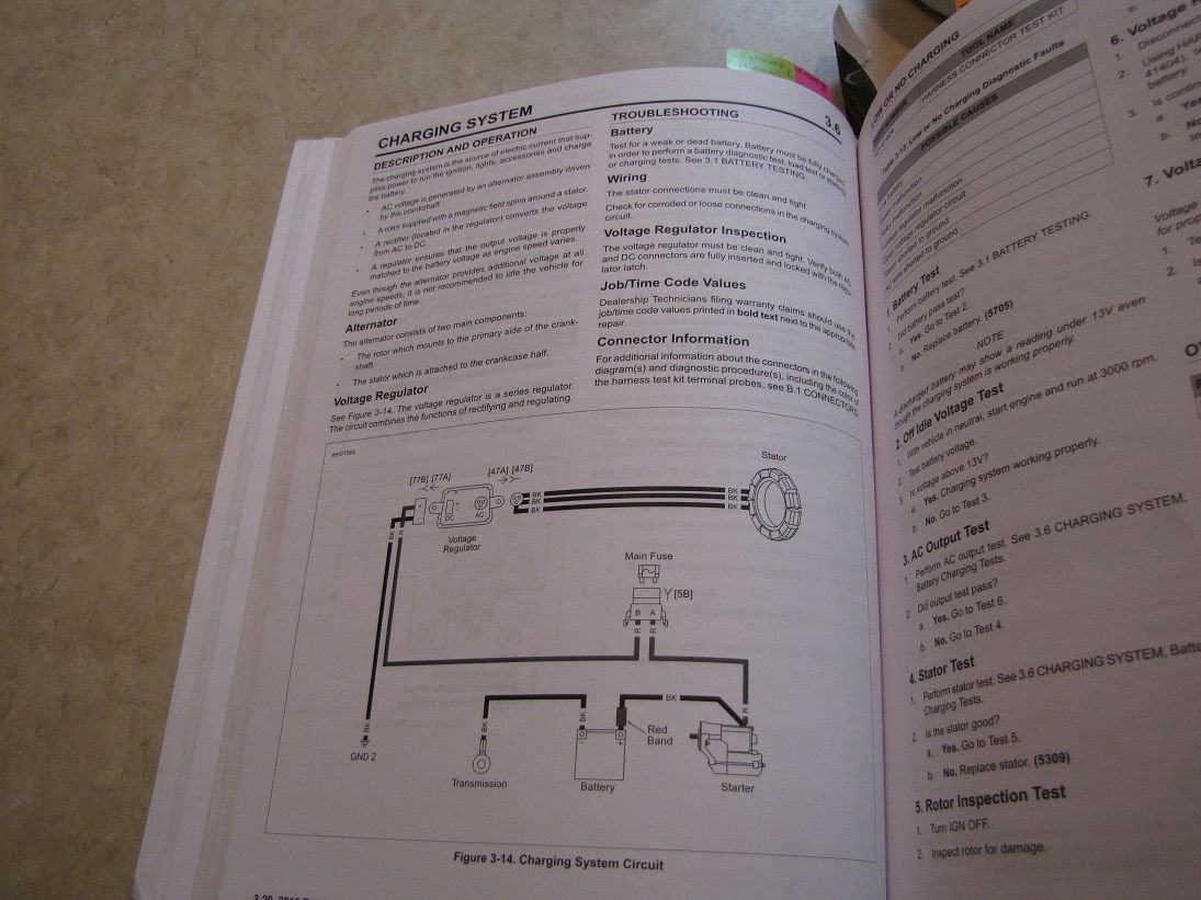

To see 16 V on the Meter makes me first think of the Voltage Regulator. You said the headlight did not dim but is there a chance it got brighter?
On the Electrical Forum https://www.hdforums.com/forum/elect...ting-alarm-43/
There are 2 Sticky's that explain how to check the charging system. If you have a meter you can do a quick check.
This is from the 2015 manual:
