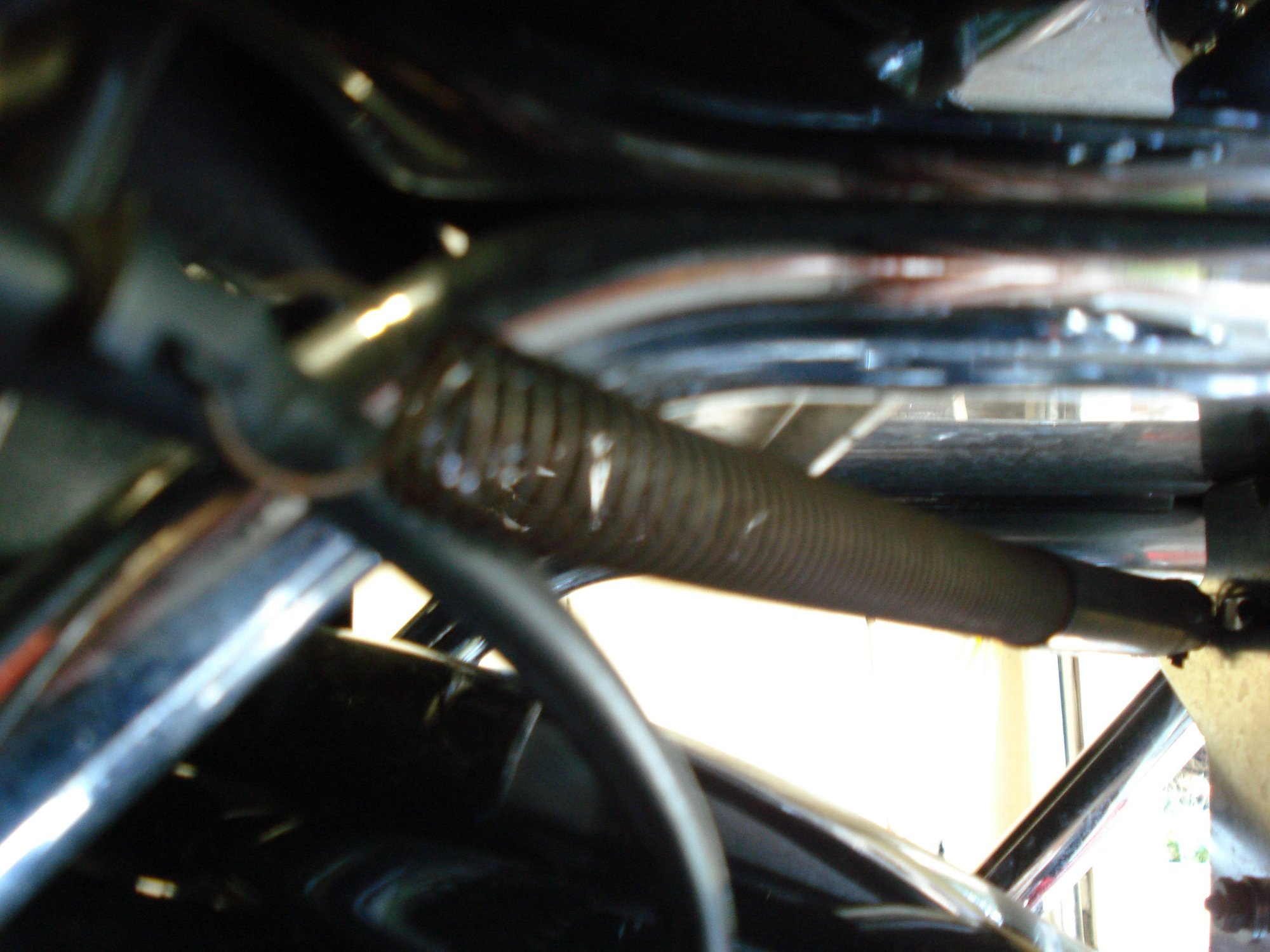

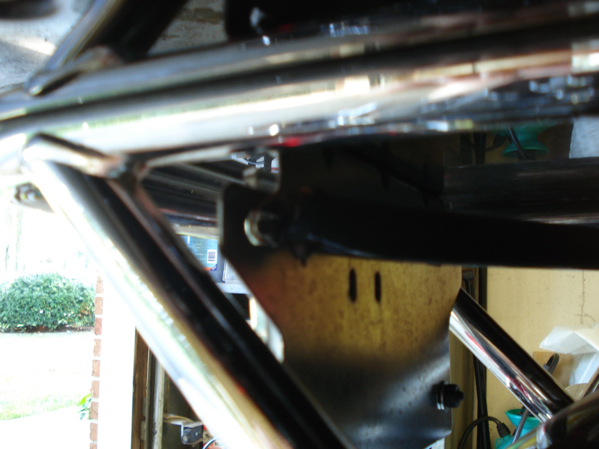

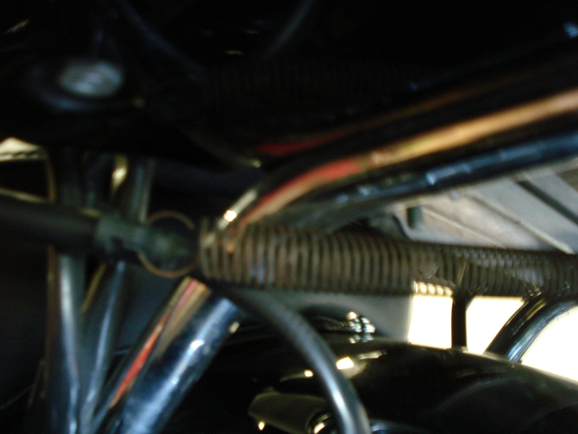

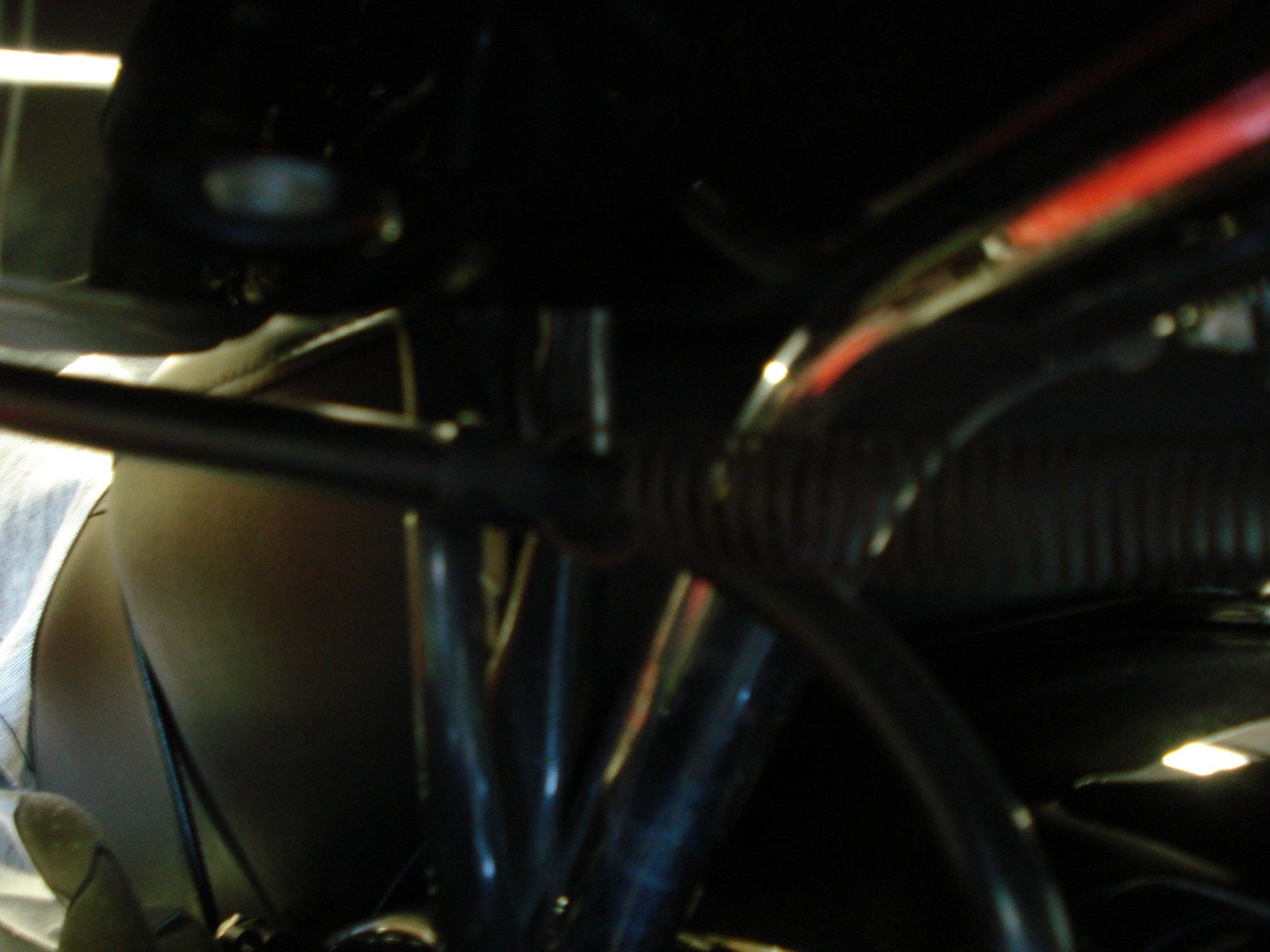

Maybe this will help?

Those are perfect!!
Thanks a lot............I'm heading to the garage to correct it.
Steve
