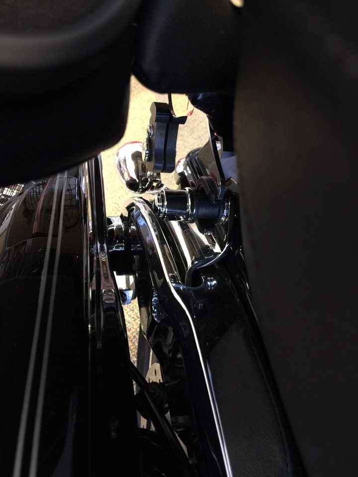

I cant really see by your first photo what the black mounting part of the stud looks like on both ends. Mine is a 2015, so a little different but I had to take the studs off of the docking plate, remove the washer and reverse the black mounting studs as one end of the stud was thicker. I had the same problem and that was my solution. Hope this helps.

Not talking about the latches - on a sissy bar the do go inside. What I mean is reverse the position of the spacers and nylon sleeve as shown in my photo. Sleeve on first, then the chrome spacer.
