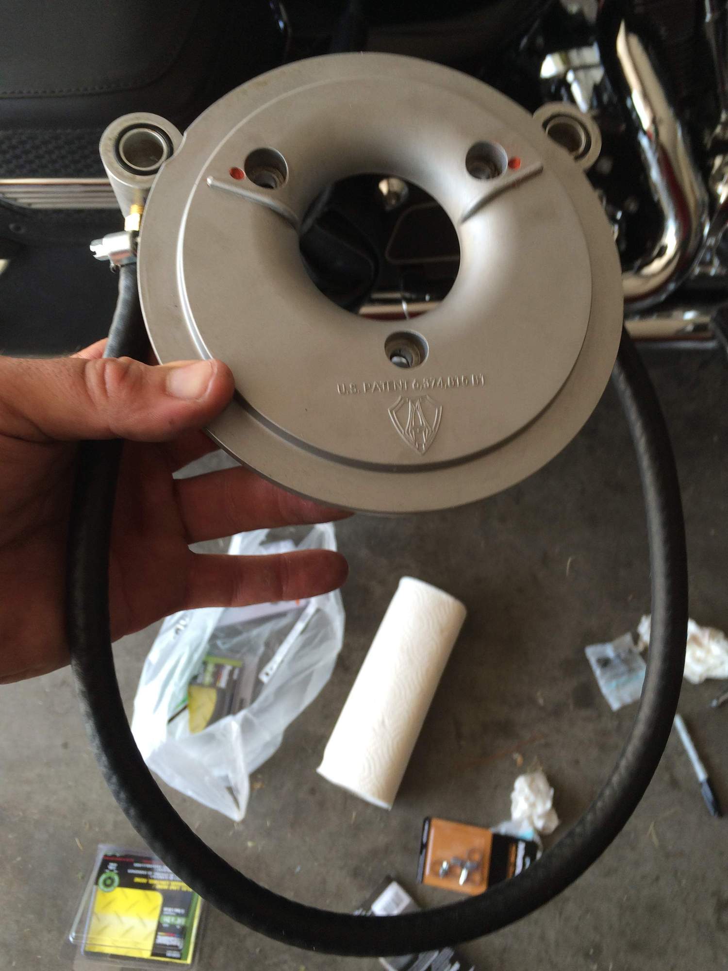

Here is my short post on doing a breather modification to eliminate oil into the combustion chamber. I have to say that I am severely disappointed that I need to do this with an RKC engine with just a little under 15k on it. I have owned this bike since new and although i added V&H power duals and slip on mufflers,an Arlen Ness big sucker and a pc 5 tuner, I use this bike to tour and to ride back and forth to work. It is not ridden hard but it is ridden at highway speeds. It has begun to push enough oil into the breather to spit out on the bike and my clothes. I have contemplated performing the feuling cam plate and oil pump but damn, i have a lot of money in this thing already. Anyway, this mod will do for now until i figure out how deep i want to go on this. I love to ride and i bought this bike new. I am running royal purple in it right now and that stuff stinks to high heaven. I haven't ridden since i just completed this mod about an hour ago but hoping some of the odor my dissipate, lol.
I started out my my Arlen Ness Big sucker so I could always go back to stock

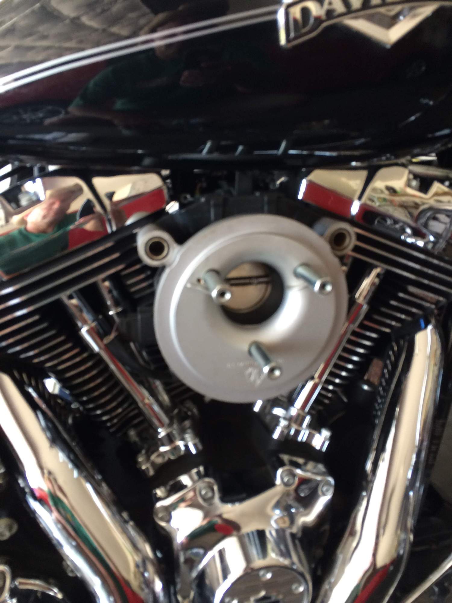

Removed ac cover and filter

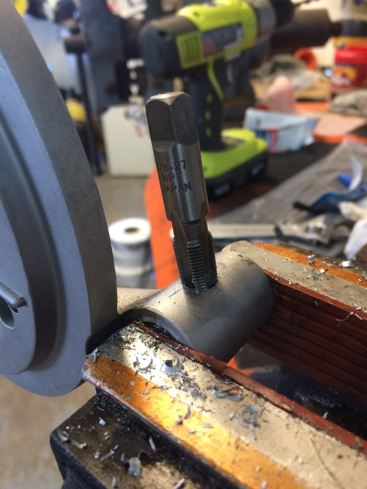

drilling the ac cover. 21/64 drill or R if you have a complete index

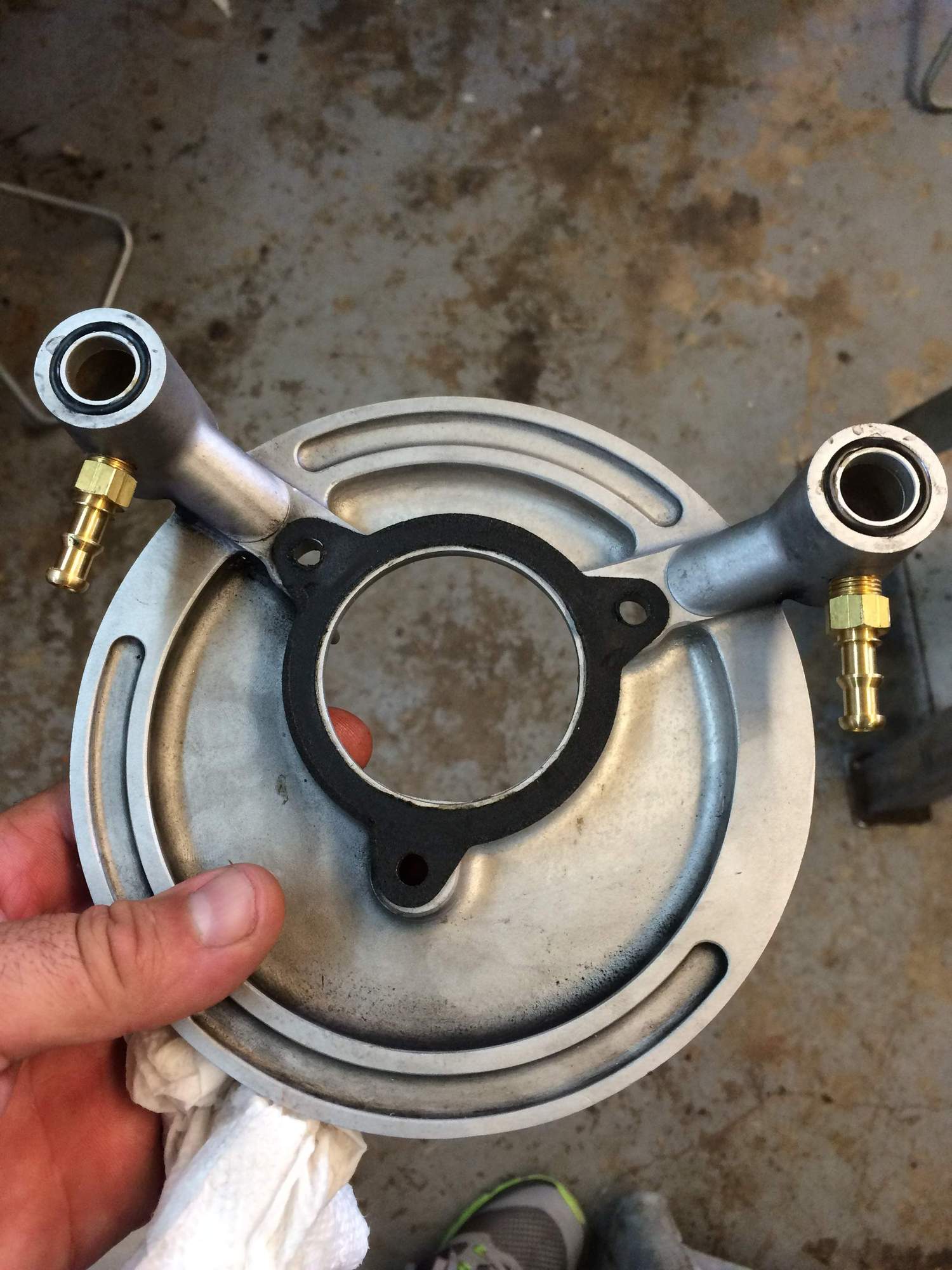

Tapping out hole with 1/8 inch 27 NPT

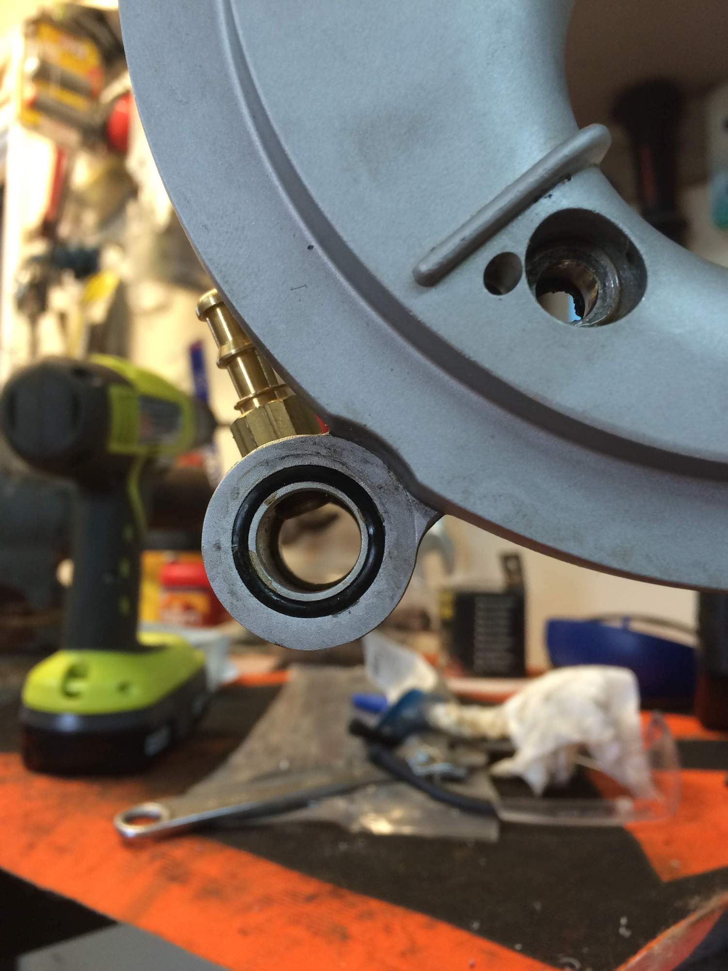

1/8 inch npt x 1/4 hose barb installed

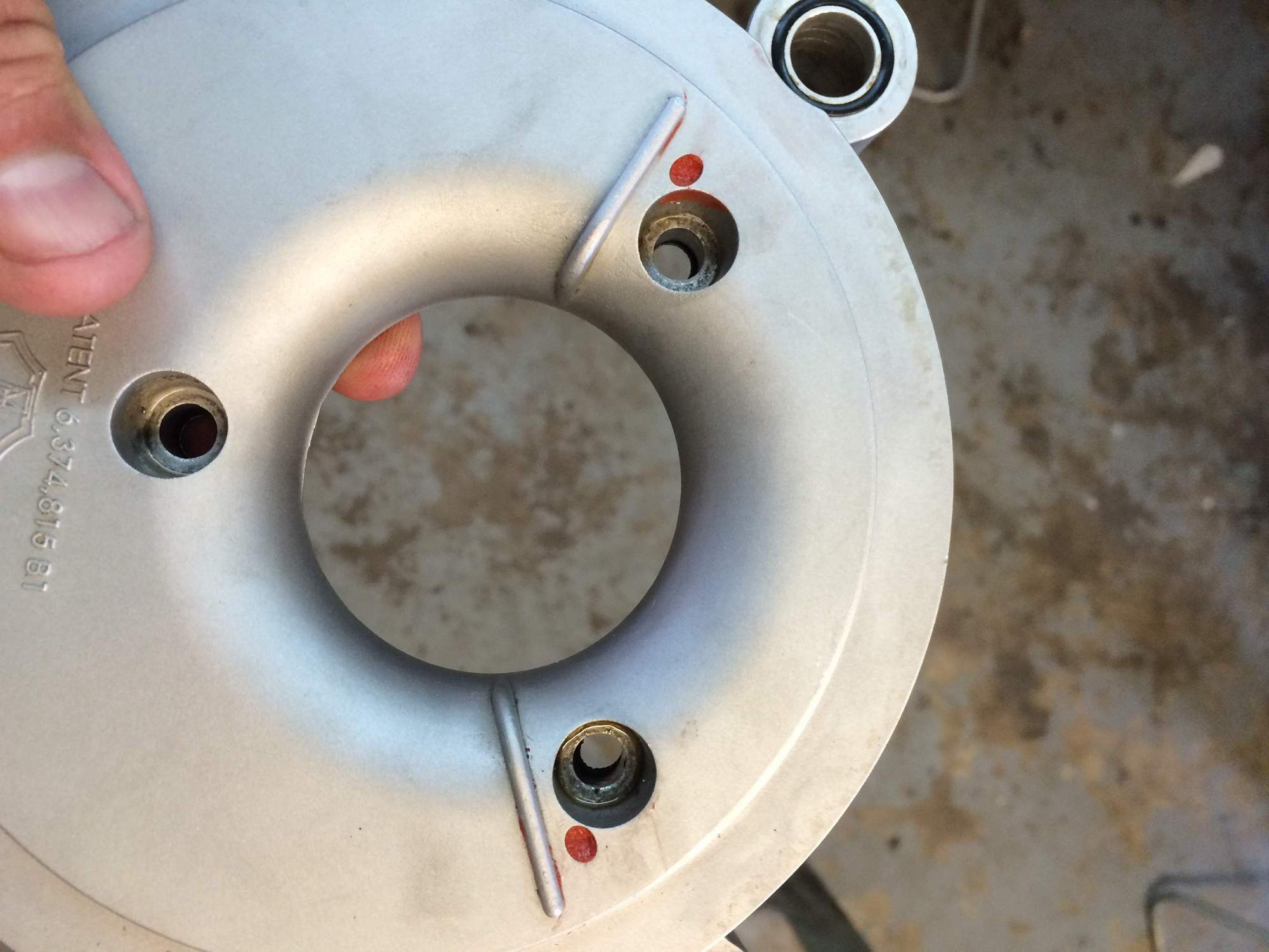

filled the holes with red rtv as shown on other threads. I had to clean a lot of oil out of the holes!
depth of hose barb
preassembly of hoses before installing ac

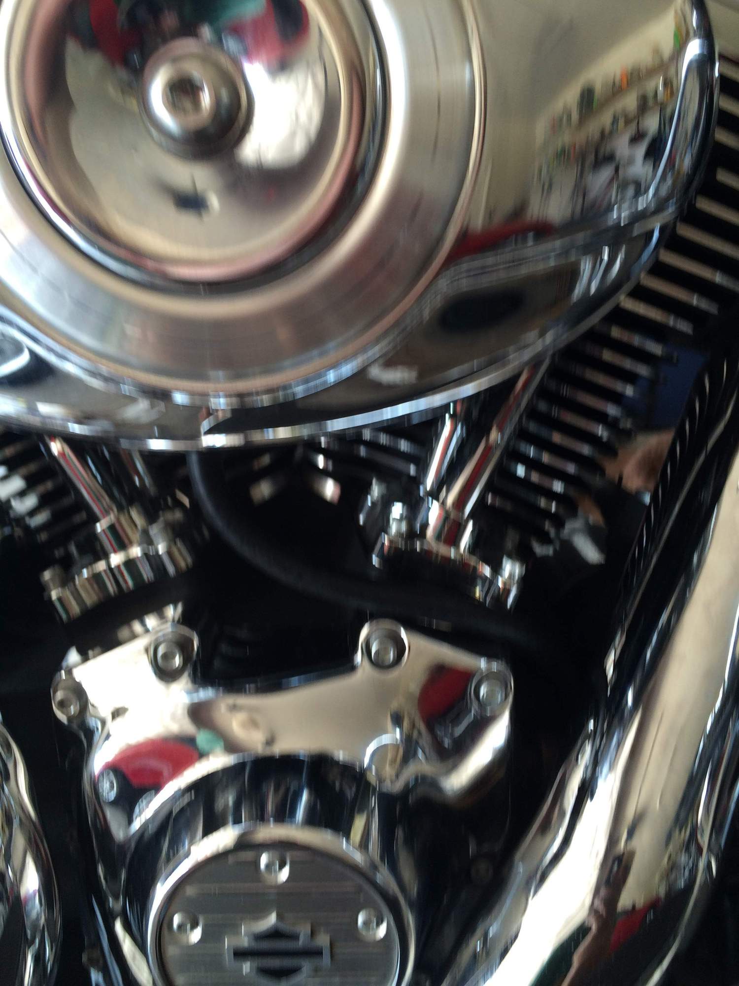

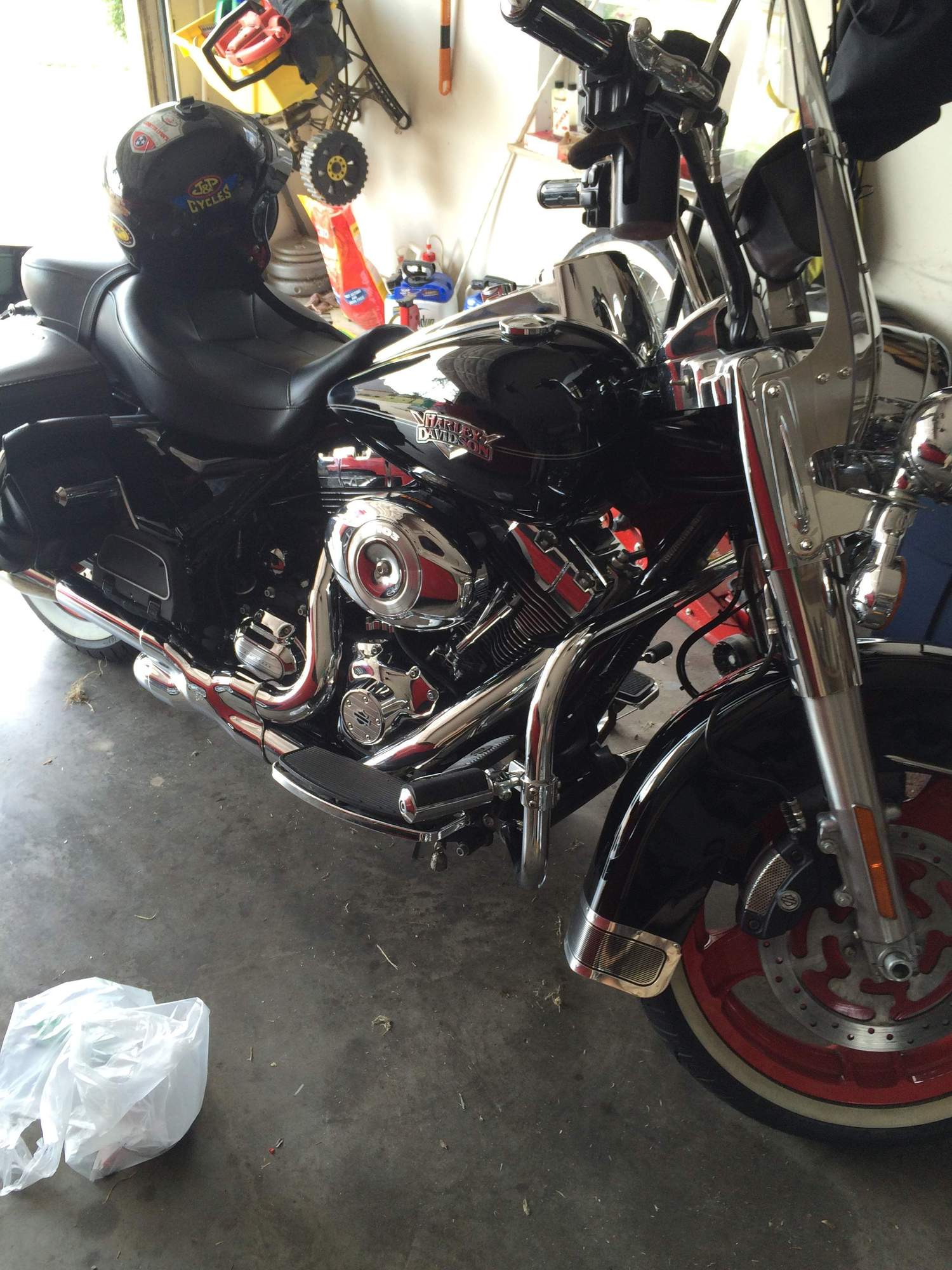

Finshed(for now) view at engine
filter nestled under frame next to oil pan

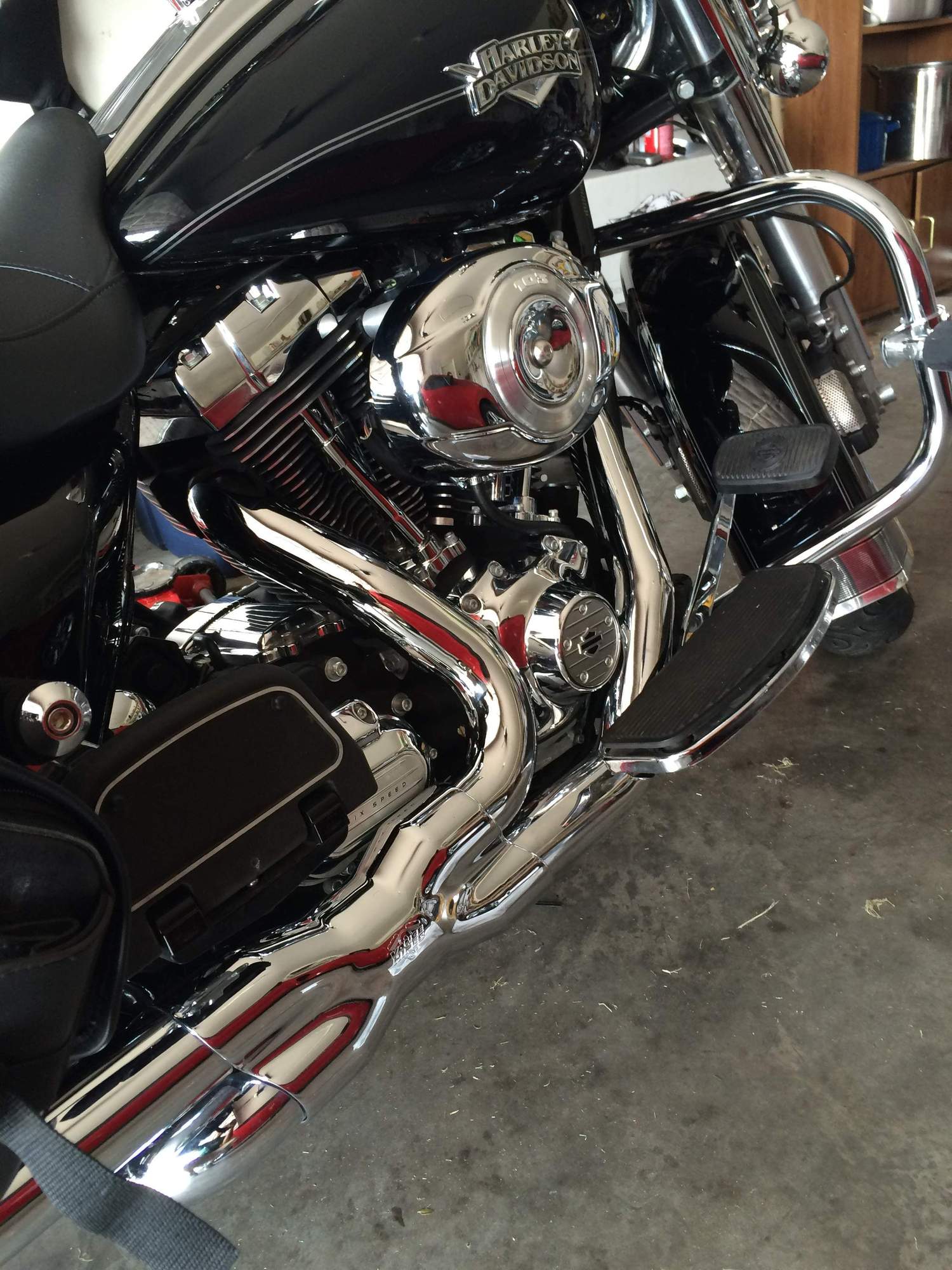

2013 RKC with 15 k miles and oil was coming out of the breather
view from curbside rear. will probably go with braided cover or smooth pipe for a cleaner look<br/>

Thanks to all of the people who have posted this mod before. It took me an hour and about 35 dollars plus the tap and drill i had to purchase which took me to 50 bucks including tax. All parts were bought at the auto parts store. 2 packages of 2 foot of 1/4 inch id fuel hose,2 packages of 4 hose clamps, 1 auto breather, 2 hose barbs for fuel system (1/8npt x 1/4),a 1/4" t fitting, plus 21/64 drill and 1/8 npt tap.

No real vacuum on that side of the throttle blade. I know there is a tiny bit but nothing in comparison to the other side. Don't worry about the RTV either as long as you cleaned the passages out well. No gasoline being passed and as stated before little or no vacuum being pulled on it. I have had mine done like yours for 5 years, except for a bottle instead of a filter, and all is well. Sure air passes over but no real vacuum is pulled.

Nice write up I ran my hose to ground no filter. Versus using RTV to block off small oil passage holes I tapped those and installed small set screws.
