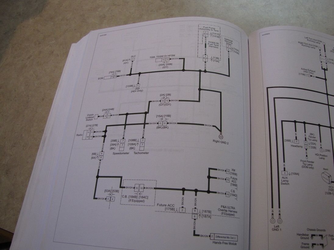

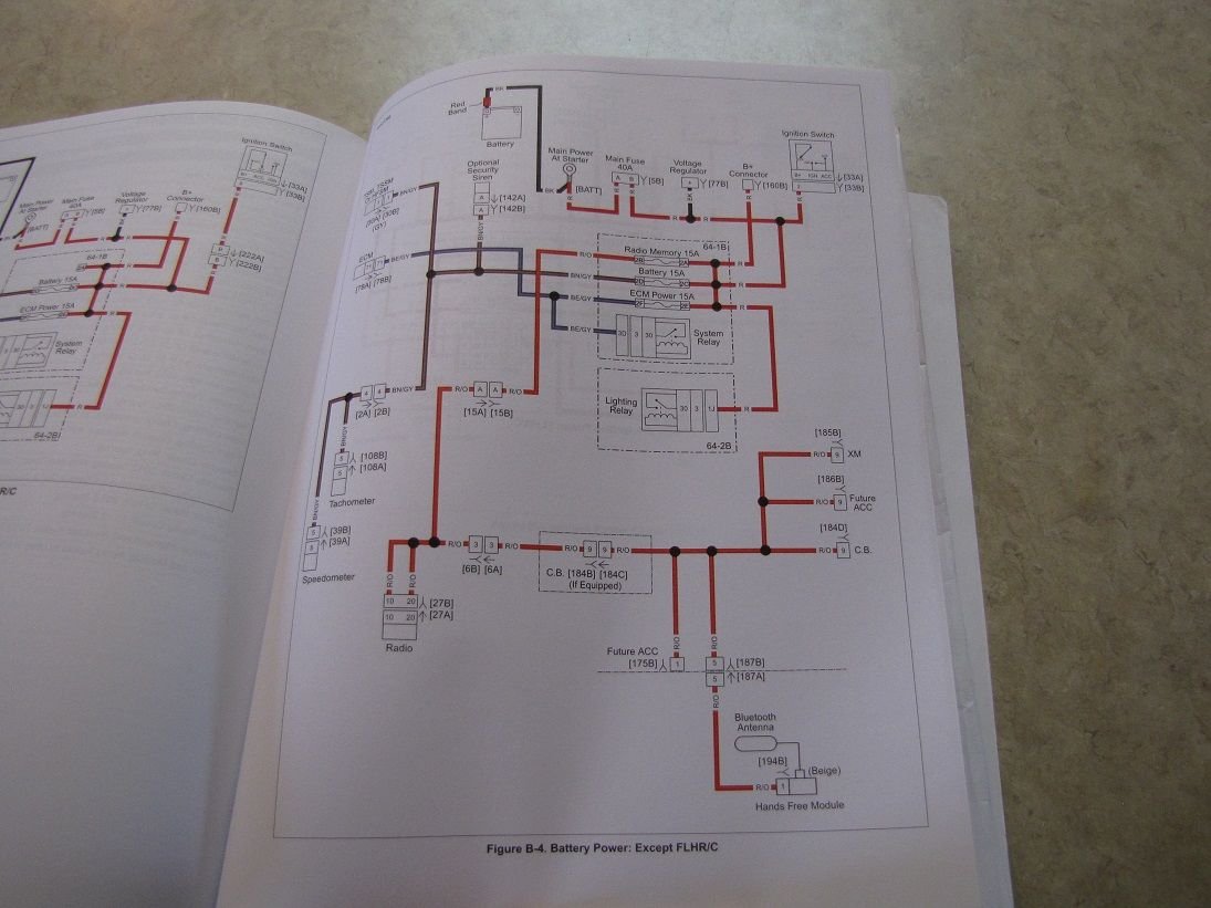

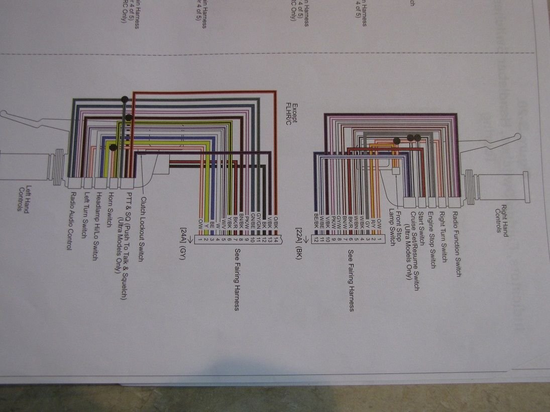

I'll try the suggestions this weekend if not sooner. Does anyone have a wiring schematic?
These are from the 2012 Manual.
Hope they help.
