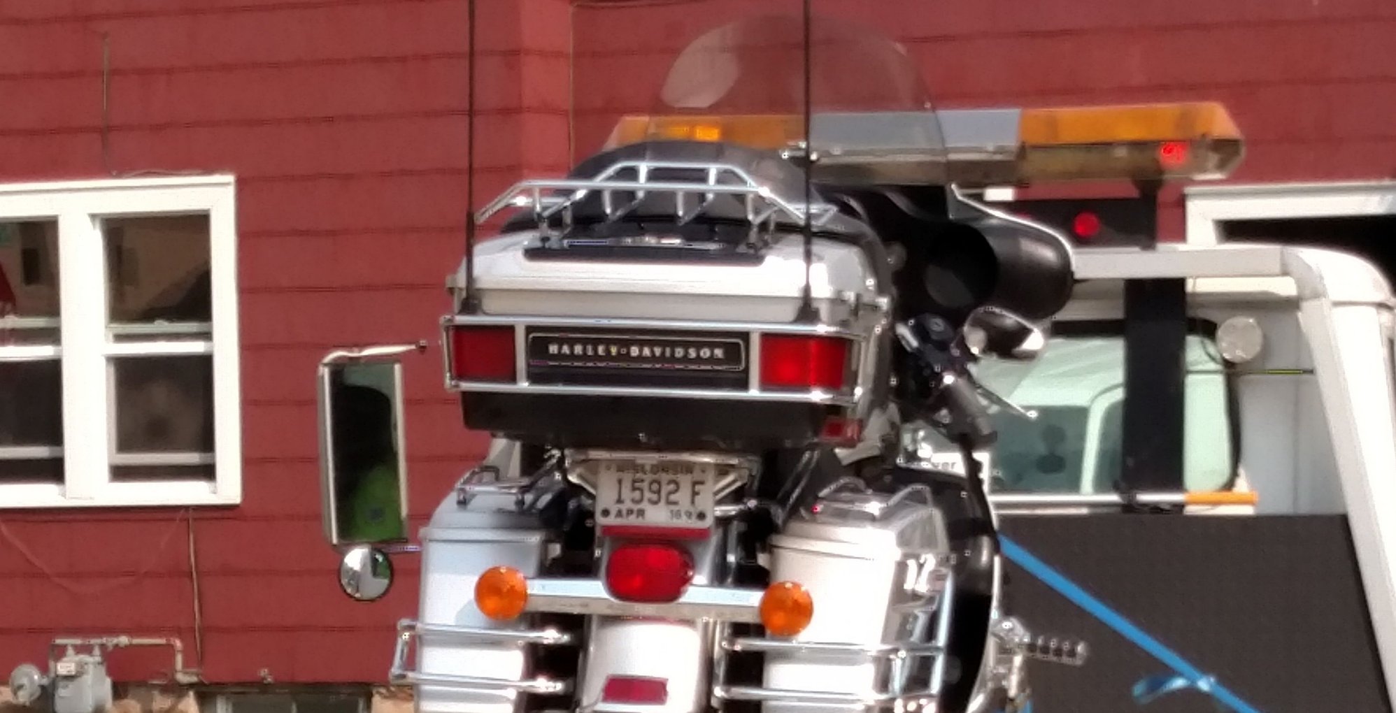

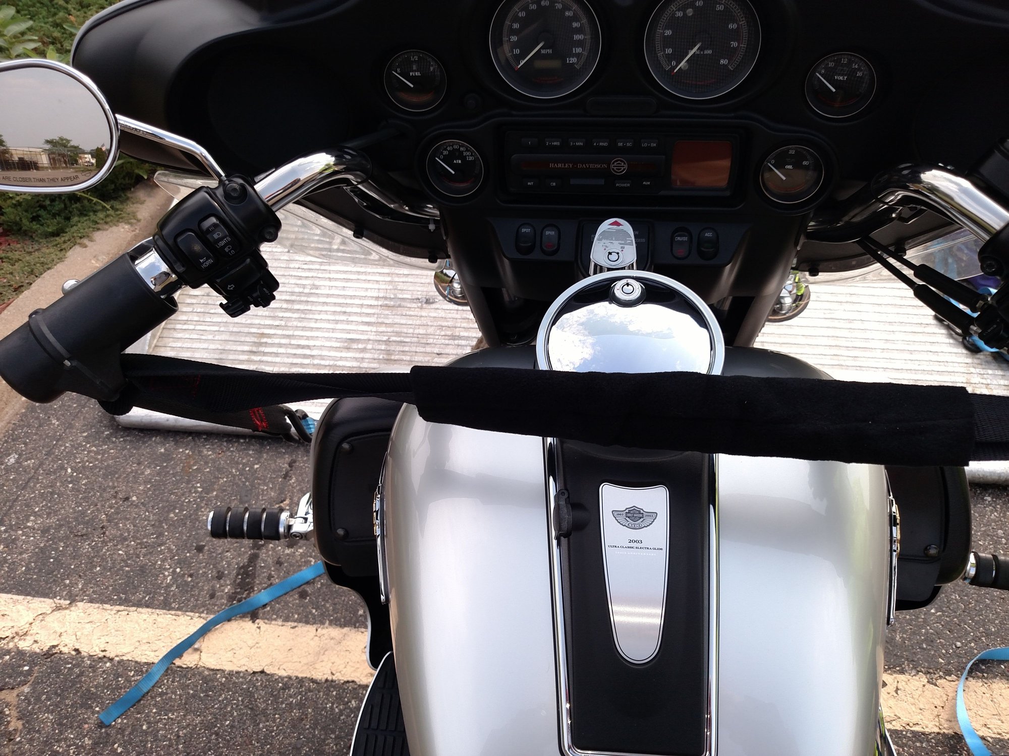

Before being strapped down
After being strapped down:
My bars never moved before this. I was meaning to learn how to check the fairing brackets anyway, so I guess it is time for me to become my own wrench. Tired of other people f'ng up my baby.
