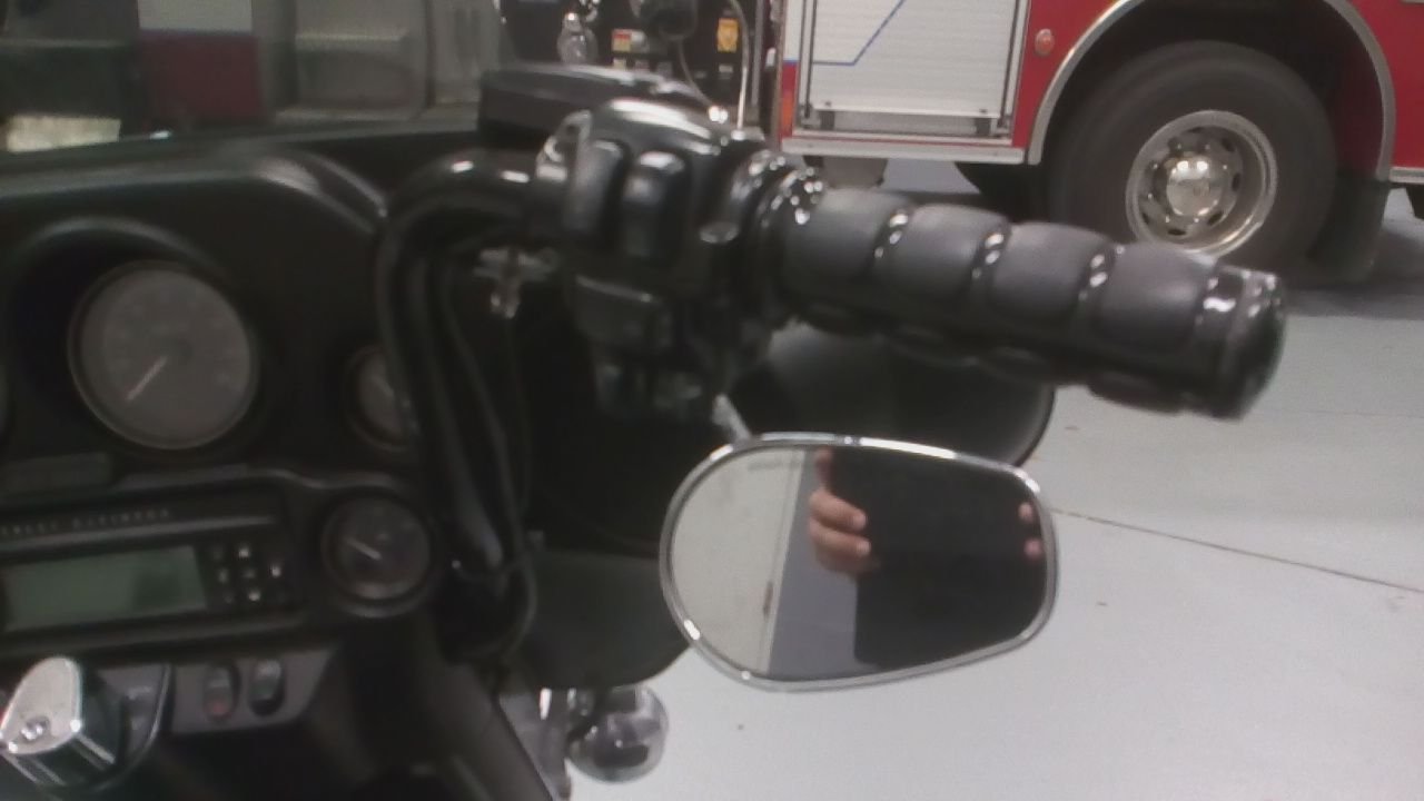

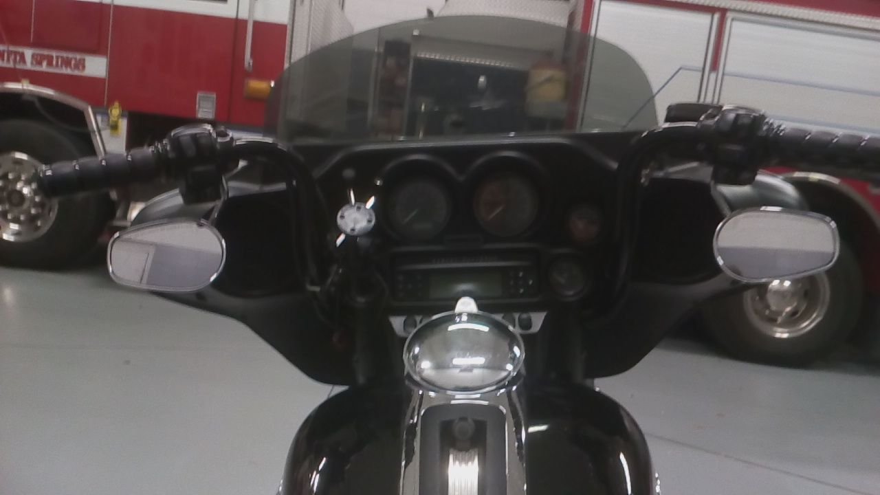

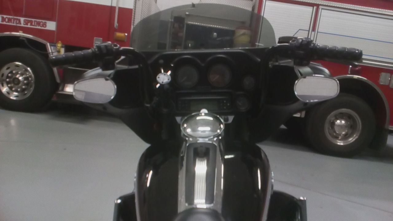

I have these bars you are interested in. I am in Florida but routinely ride in North Carolina due to having a uncle that lives there that I can stay with for free. I thought with the 12's on, I actually had better control of the bike in the twisties.
For my mirrors, all I did was flipped them and put them on upside down. I really like the look of them.
Much more comfortable ride with these bars on over stock. I had mine put on because it seemed like a real pain in the ***.
I can't speak on the controls since I have stock controls.
I also went with black bars. If anyone can explain it to me, I will put pictures up. Or pm me your email and I'll send them that way.

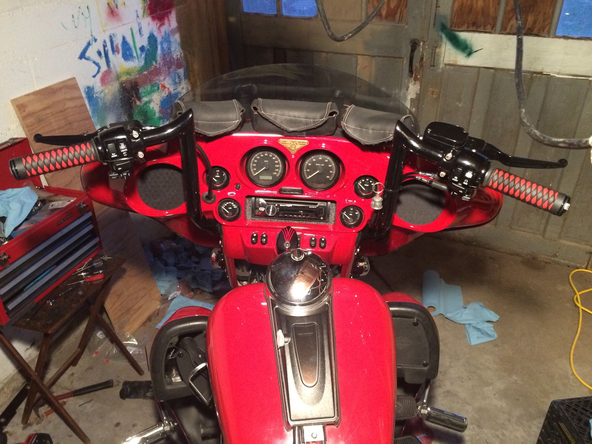

12" Yaffe Monkey bars on a 07 Ultra.

Default Pictures hopefully!

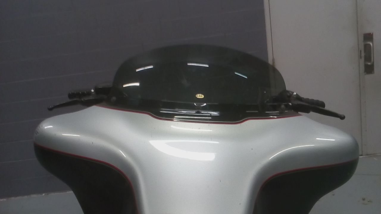

I installed the 14" yaffee monkey bars this spring on '09 SG. I can see out mirrors a lot better than with the 13" cycle smith bars I was runing previously. I am 5-10 and my hands are just slighly above shoulders. The yaffe bar height measure differently than the cycle smiths as these are a couple inches taller. I do all my own work but these took a little patience to install because of the sharp bend in the bars to snake the wiring. The right side of the bars
were not deburred from the factory and getting a file in there is impossible - I fished through an old bicycle chain and pulled back and forth and was able to clean up the sharp edges. Wrap all wiring in electrical tape or shrink tube and lube up before you try to run through. Will need to push and pull wiring a little at a time to get it through the bar bend, slow going - this is where the patience wil come in. When all was done It was worth the aggravation.

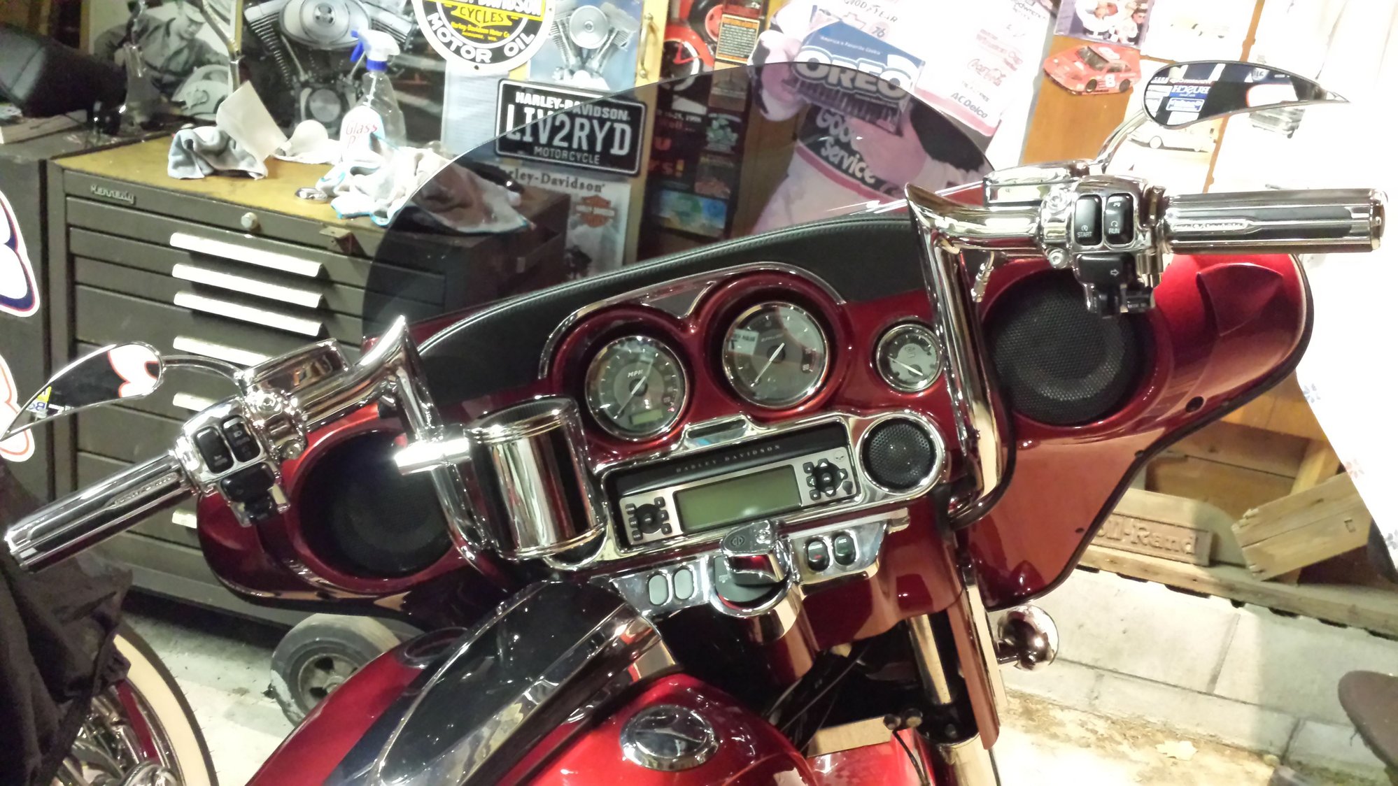

Have you got shoulder issues? I got the bars in question.I don't have shoulder issues until around 80 miles in.They are DIFFERENT.Do i like'em?
Yea they look the *****...Will i switch them back? No purchased bike with them.
Picture also shows the Yaffe trim pieces to go in place of stock mirrors.
Dale, i don't like saying this to another man but, that's just pretty. You have beautiful bike and those apes really compliment the look. No shoulder issues but I will get that numb tingly feeling in my hands from time to time. Regarding the possible shoulder issue, I'm wondering if its due to have to large of apes. Ultimately, I would love 14's but I'm thinking they may be to large and uncomfortable for long hauls. Anyway, tomorrow morning, I'm picking up my CFR's from a mod shop (4 long months of waiting). I'm gonna get a quote for them to do the install.
Again, I really love the look of your bike. Thanks for sharing.
