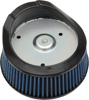

I picked up a 2014 air cleaner thinking that I could just use the Cover to replace the Football cover on my 2010 big sucker air cleaner. Well as we all know that won't work. If I buy a 2014 Stage 1 air cleaner will that fit the back plate assy of the 2010? Or if I buy a complete 2014 Big sucker assy will that work/bolt onto my intake? Any help is greatly appreciated.

IDK if this helps but I have a complete 2014-15 air cleaner assembly on my 2010, I do not have a stage one done. If the complete assembly fits I would assume the stage 1 air cleaner kit for a 2014-15 would fit as well.

Have the same thing on my 09. I would also assume it should fit. I'm just going to leave mine like it is with the complete stock intake from the 2015, from what I have heard, the 2014 and 2015 Rushmore intake flows 15%-20% more air than previous years.

The pre-14 air cleaners will work on a 14 and vice versa. If going stage 1 with a 14 air cleaner cover it needs to have a backplate compatible and/or specific filter element to make the cover work.

There's a way, the backing plate portion of the stage 1 kit is the same - if you want to run the 14+ cover then a rubber "gasket" of sorts is needed to fill up the gap. We have these at work for the Screamin Eagle Stage 1 kits - I should check and see if they fit the Arlen Ness kits too since I have one on my 2014 - I think it would since AN makes the SE stage 1 kits..

WRONG MOVE..
You have the 2014 Backing plate correct?
It is proven to have much better flow characteristics to the previous negating the need to install a BigSucker or equivalent. It is essentially a Stage I upgrade. Just install it along with the rest of it.

Here's a shot of the 2014 AN Big Sucker for a 2014 next to the 2014 conversion filter, diameter is the same - hole spacing has to be the same since the throttle body hasn't changed.

That is precisely what I have installed on my 2010. Just make sure you order the proper stage one kit (the one with the gasket, spacer, and longer bolt) and you're good to go.
A good point about the longer bolt - I had some brake rotor bolts laying around and it fit just right - now mine comes off with a torx bit but you can get longer ones at many hardware stores that sell chrome hardware
