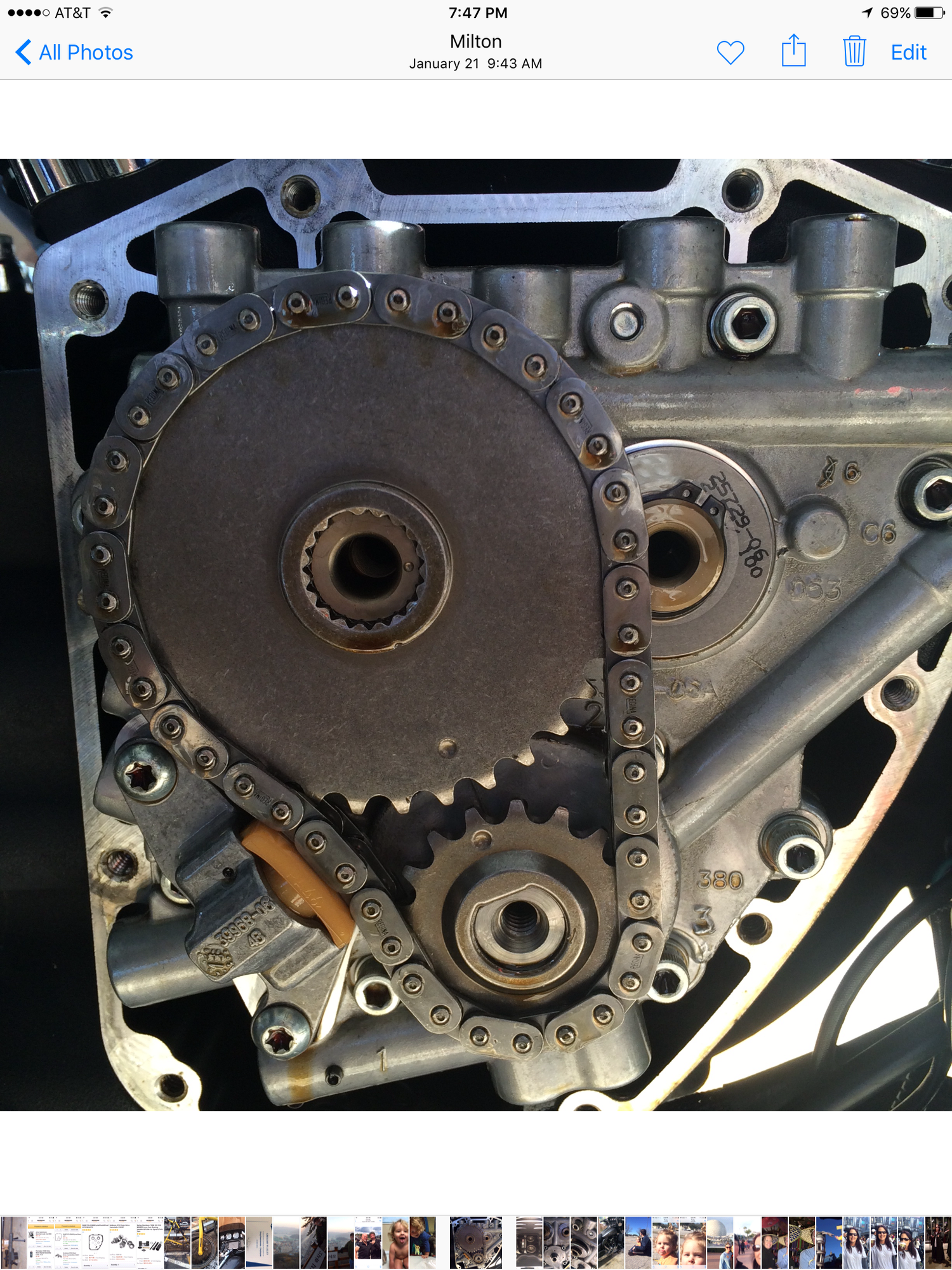

Here's a pic of the timing chain tensioner when I replaced the cams about 12000 miles, it had absolutely no wear to speak of!
