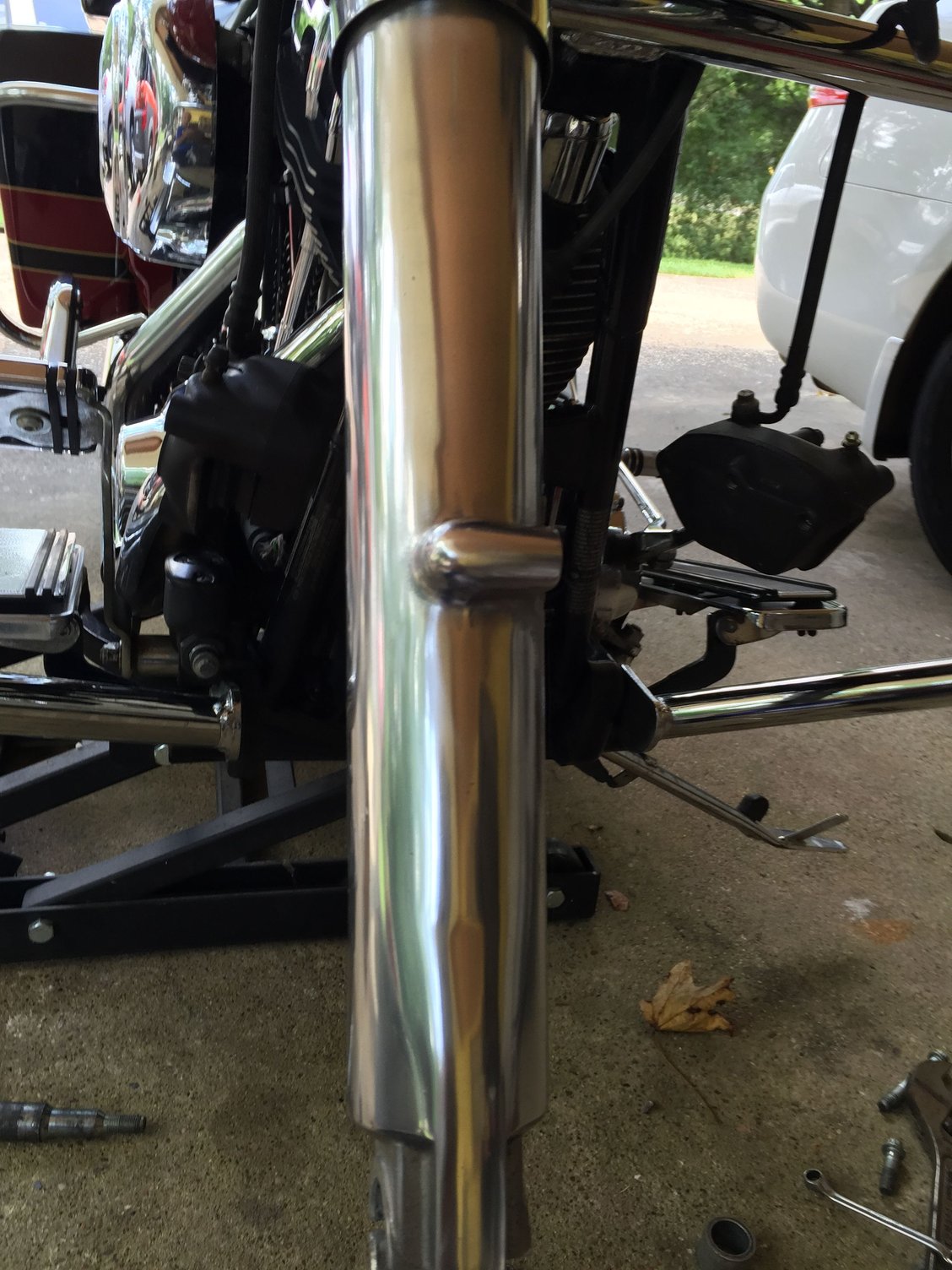

I got a 3m headlight restoration kit and a 1/4" drill. Took off my wheel and fender. Sanded the forks and then polished with simichrome. Took about two hours

Lookin' good "Jax"

The clearcoat sands off easily. I didn't even pull the wheels when I did mine. One warning, if you ever have to deal with salt of the roads in the winter, you don't want to do this. Road salt will attack the bare aluminum, and you'll have to polish them again and again. Mine were shiny like Jax's picture when I first did them, I need to get off of my butt and polish them.
