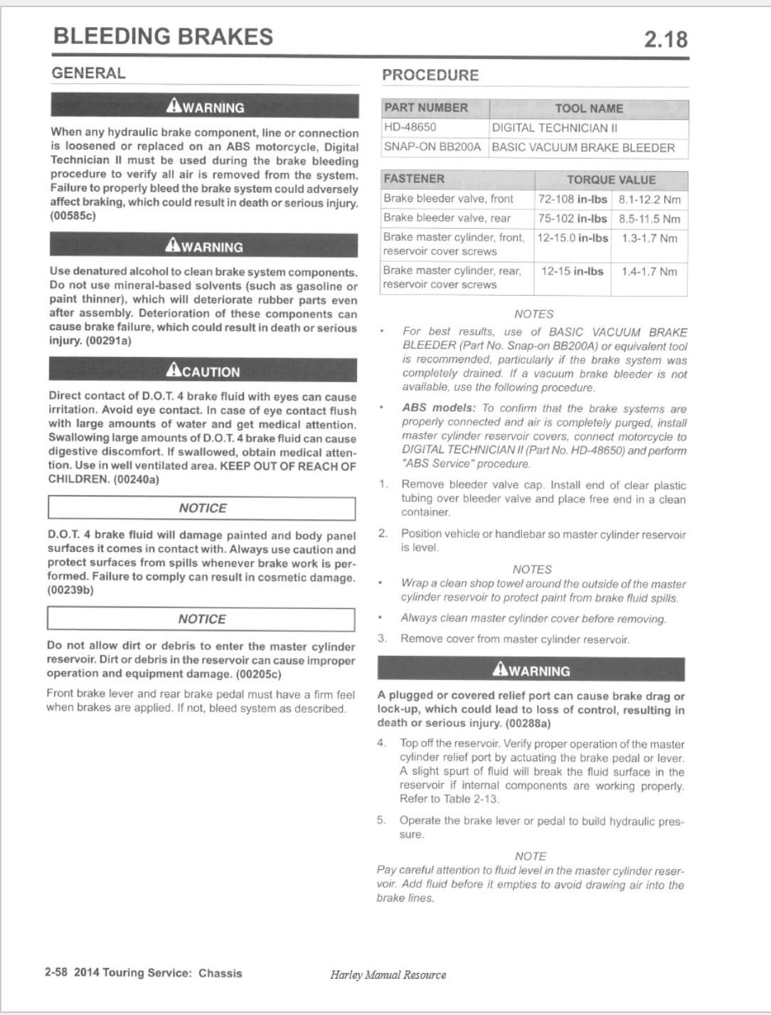

Old Nov 18, 2015 | 08:18 PM
Gwaxley's Avatar
Gwaxley
Posts: 1,745
Likes: 36
From: Lafayette La
Originally Posted by SgtMic
Bleeding ABS on these newer bikes requires a trip to the dealer. The ABS block has some proprietary newfangleness. My '09 had to go in.
If your silly enough to open the hyd system or let the master cylinder run dry as you bleeding the system you will need a vacuum pump to ensure all of the air is removed for the system, as the manual states.
But you can pump fresh fluid through the system all you want or need as long as you do not let air enter., as the manual states. Pay close attention to steps 4-9.
