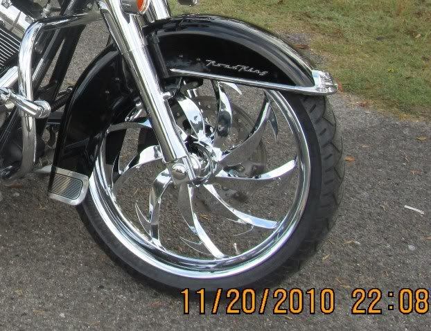

Here's my original fender, with a 21" wheel, on my 2010. Did not have to drill. I did lower the front to maintain same geometry, but that does not affect the clearance of your tire to fender.
