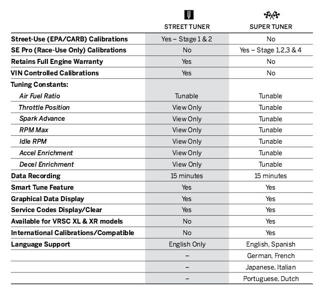

The comparison is the race tuner (pro) and the street tuner,
the street tuner allows for uploads of Harley's EPA compliant maps only,
the race tuner allows you upload and modify, VE tables, timing, idle, and a bunch of other stuff I shouldn't mess with. It has smart tune that allows you to record your ride it will analyze, and adjust the VE, tables accordingly (build the map for you).

But to answer the OP's question, here are the differences for the HD tuners
Street Tuner: Screaming Eagle Street Performance Tuner (SESPT)
Super Tuner: Screaming Eagle Pro Super Tuner (SEPST)

If you get the tuner from HD make sure it is the (SEPST)
Screamin Eagle Pro Super Tuner. It will do what you need. Understand it is (married) to your bikes ECM by vin #. You CAN NOT use it on another bike.
It can easily adjust your rev limiter, timing, AFR,VE tables, has a smart tune or a live tune option. Has ability to check DTC , and clear them...etc.
