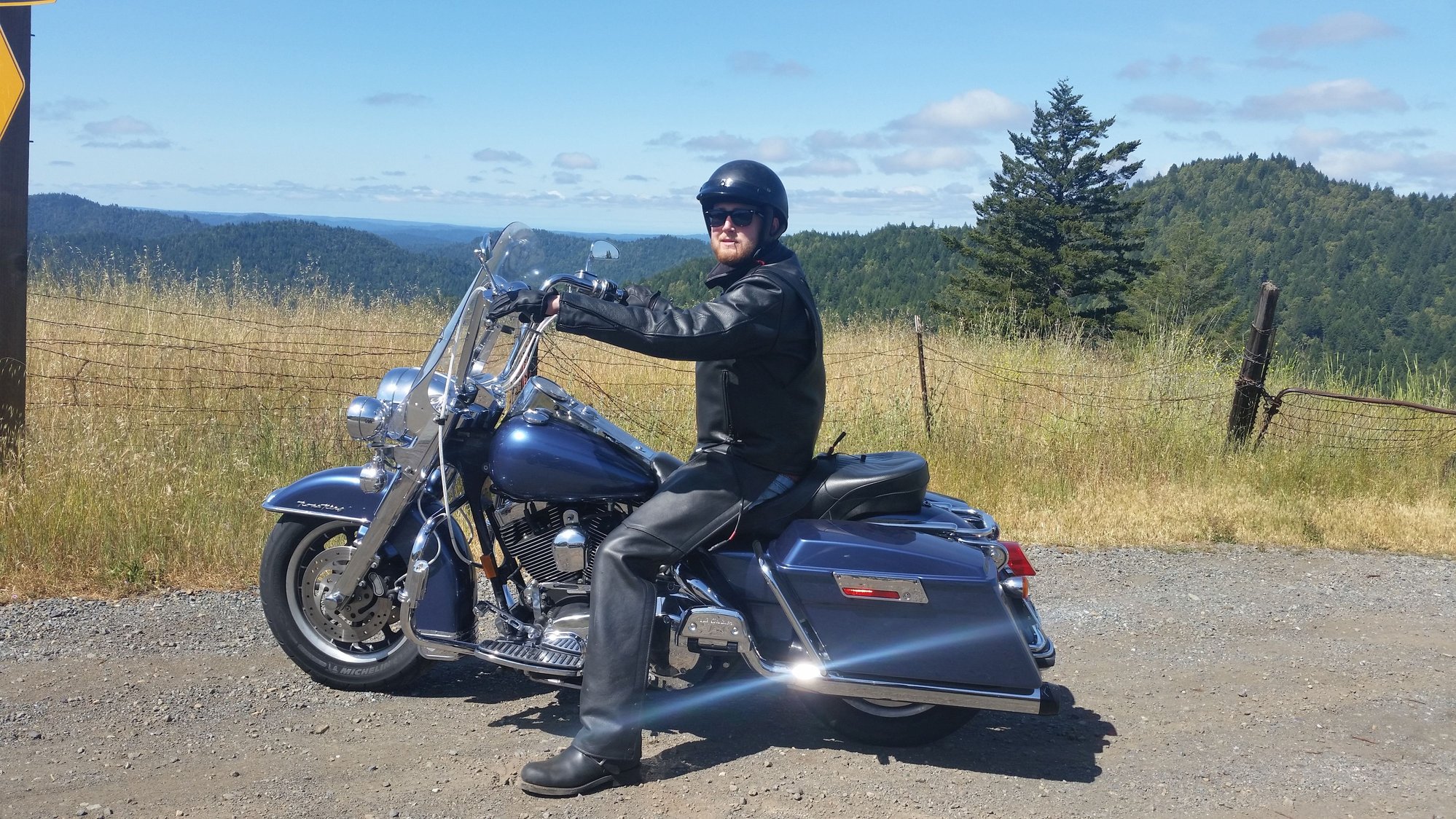

I installed WO 14" Apes on my sons 06 RK as well as my 08 RK. I used Magnum Shielding +8 clutch, brake and throttle control cables on his 06 and +8 clutch and brake cables on my 08. I used NAMZ handle bar wire extension kits on both. I ordered the longest wire kits I could so I had plenty of wire to stagger the solder connections inside the bars. It is only a few dollars more for the 15" kit vs their 4" kit.
http://www.namzcustomcycleproducts.c...to_06.html#top
With respect to height we are both 6'2" and these 14" Apes put our hands about level with our shoulders as you can see in the attached picture of my son. You will have to decide what is comfortable for you.

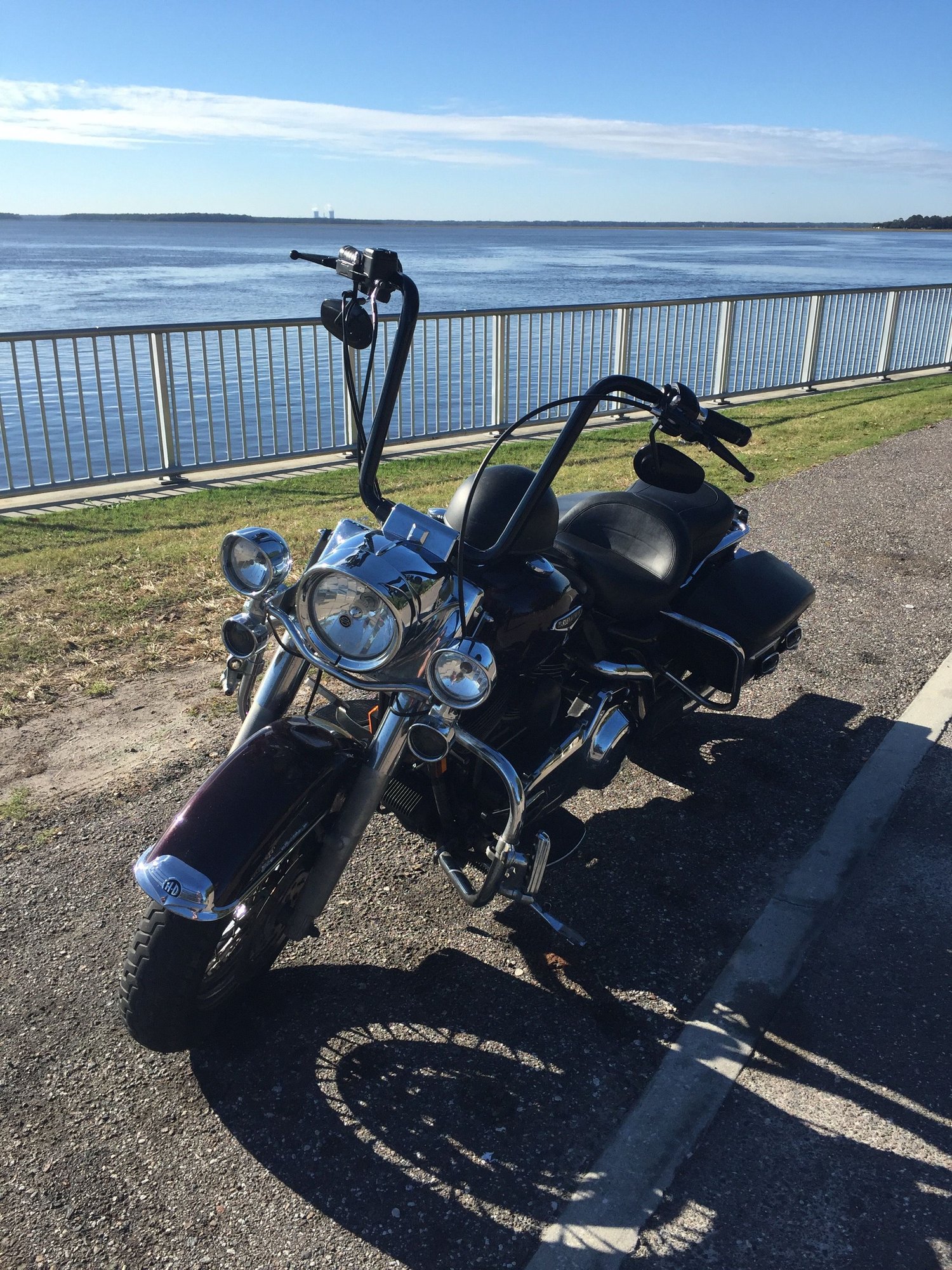

Here's mine with the new Monkey Bars.
