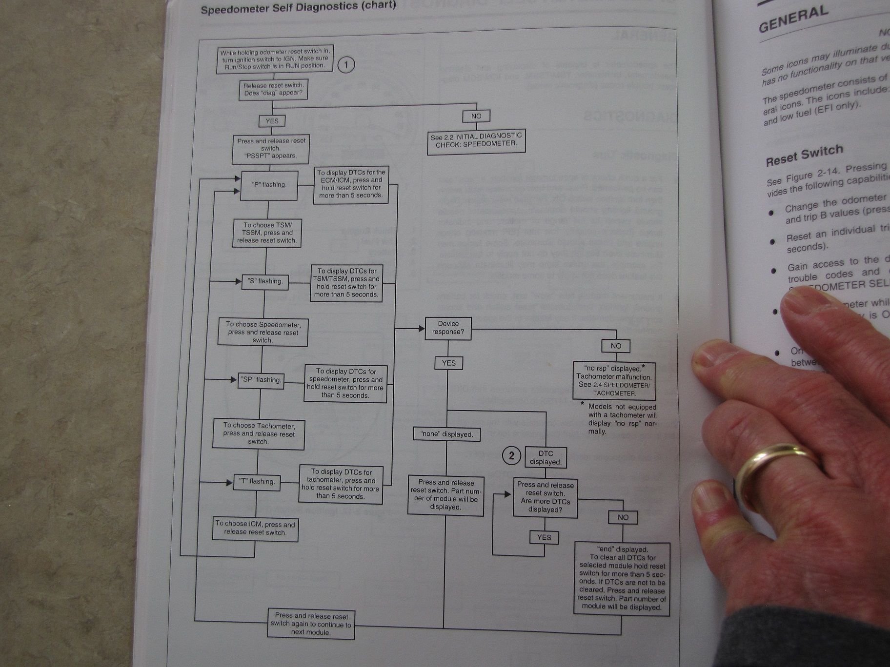

I'd go through the procedure again just to make sure.
Here are some instructions from a 2004 manual:

For an 02, the code check is different. https://www.hdforums.com/forum/ignit...s-00-03-a.html
