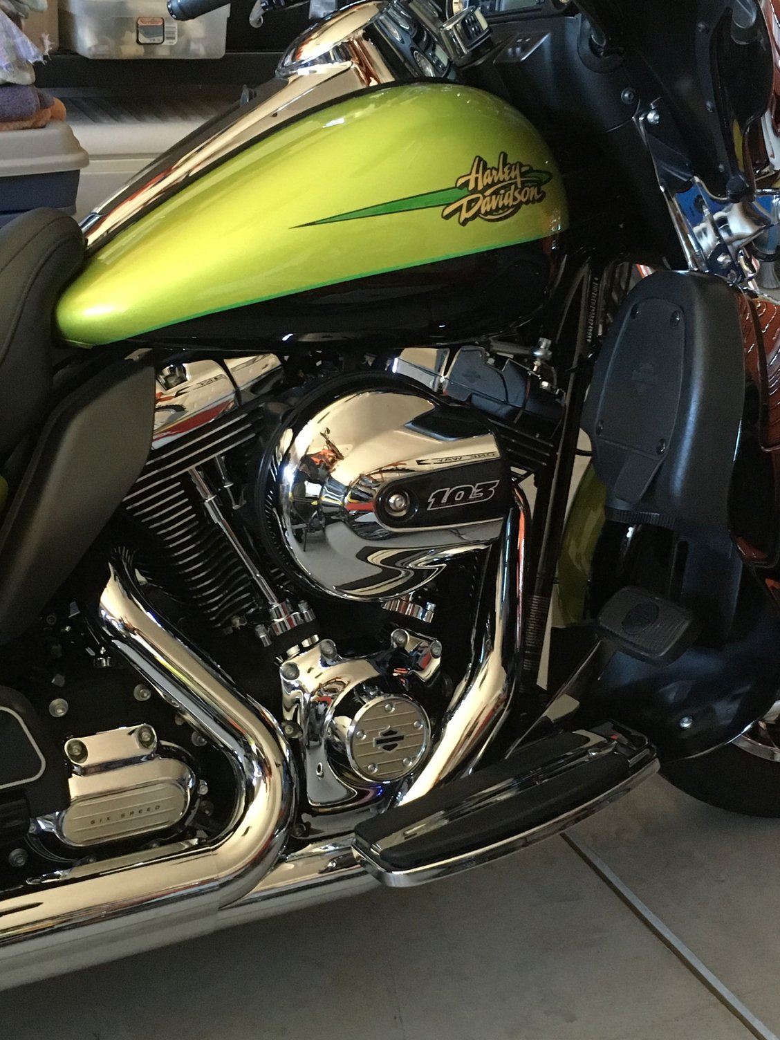

I just put one on my 2011. It took five minutes. You just need the back plate, the air cleaner bracket, the vent hoses, the filter element and the cover. I bought mine for $27.00 on Ebay.

[QUOTE=dribble;14873825]

Looks good.
