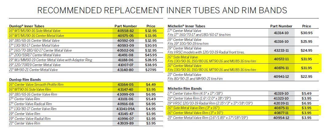

Hey guys, looking for an assist here. Im swapping out my tires for some white walls for my 07 FLHRC. Should I go ahead and do the tubes too?
Can anyone confirm if this is the right part number? The fitment tab doesn't show anything on HD's site. (really helpful)

Do tubes and rim strips

yes new tubes and rim liners,dont get from drag specialties,they use cheep china tubes stick with harley or honda tubes,i like the honda ones they have a long 90 valve stem makes it easy to check and add air.

New tires = New tubes AND new rim strips. Always. No problems.

rgr that. so what the hell are rim strips? can anyone confirm with me on the part number?

Originally Posted by knappoleon
lol
Choose appropriately

Ok. I know this is a dumb question, and I'm going to ask it anyway. What's the point of side and center valves? Is the front center and the rear side?
holy s. dude!
Just look at your wheels .
Are they on the center-line of the rim or offset to the side?
