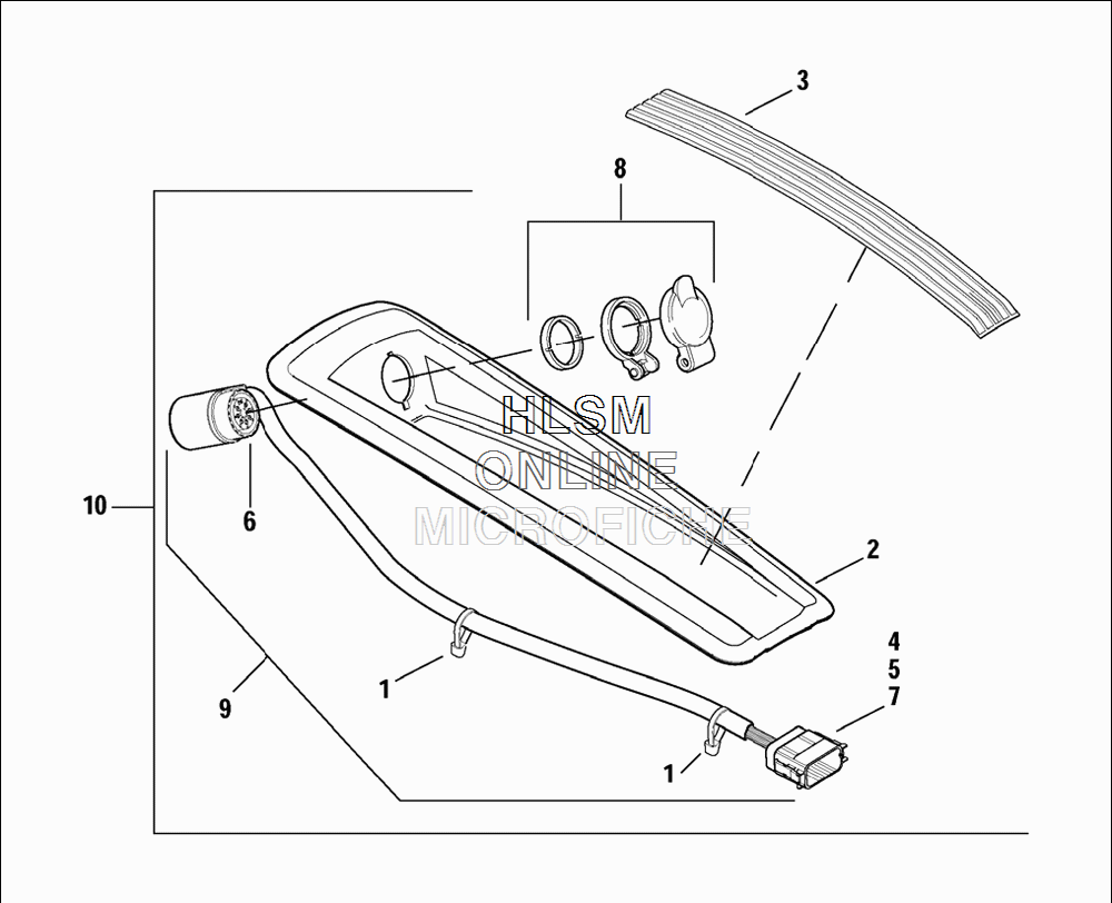

Pull the cover down look at the connector, you'll see a little metal ring around the outside and you need to unscrew the ring. It has 2 small slots you may get a small screw driver into to start it.
http://partsfinder.onlinemicrofiche....0CONTROL%20POD

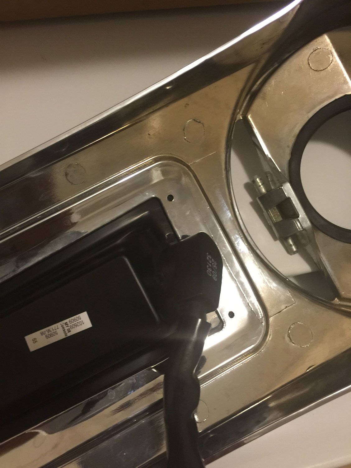

See if this helps.
