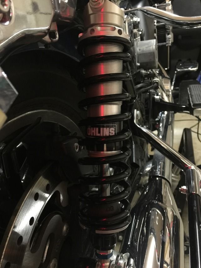

Thankz guys. .. but can we save the who's better and just share what we use... thanks
Just installed ohlins hd159 (equivalent to howard's 3-3 shocks) on my 14 sgs last week. About 200 miles on them so far and they ride fantastic, definitely happy I went with ohlins.
