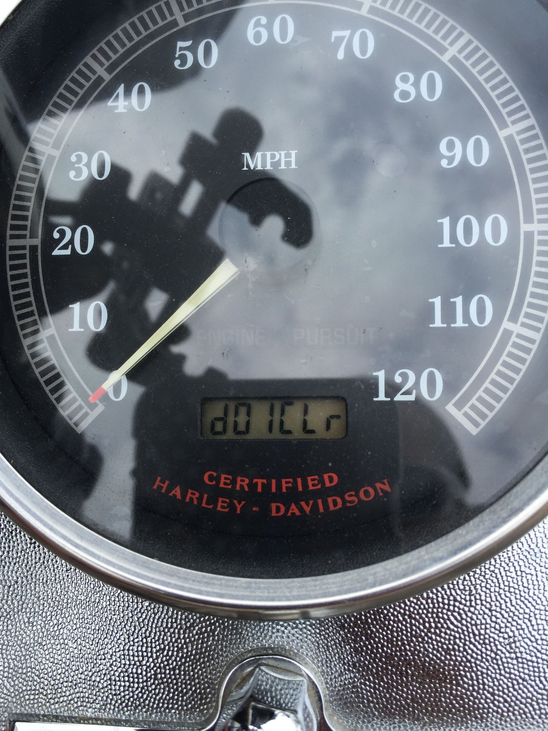

Morning folks!
Filled up with gogo juice this morning and before resetting my trip mileage this popped up on the speedometer miles readout
Goes from 1 to 10 then after the 10th push it goes to CAL 03
Any ideas what in the heck this is?? I turned the bike off and then back on to reset the mileage counter and that was that...
Nate

That's a code inicating a problem, could be something simple like a lightbulb or weak battery... Sorry I can't tell you more..not sure if the manual has any thing on deciphering these or not, you can try a Google search for Harley Davidson trouble codes

The diagnostics can store fault codes in a number of slots, ie D01,D02,D03 etc. Yours is saying slot d01 is clear (CLr)
This could be because either the trip reset button used to retrieve codes is shorting out, or more likely there is wires pinched under the speedo console. Try lossening it and see if theres anything trapped under it.
If the code has CLr added (d01CLr) which means clear no problems
The CAL 03 will be the last one Calibration 3=Domestic
