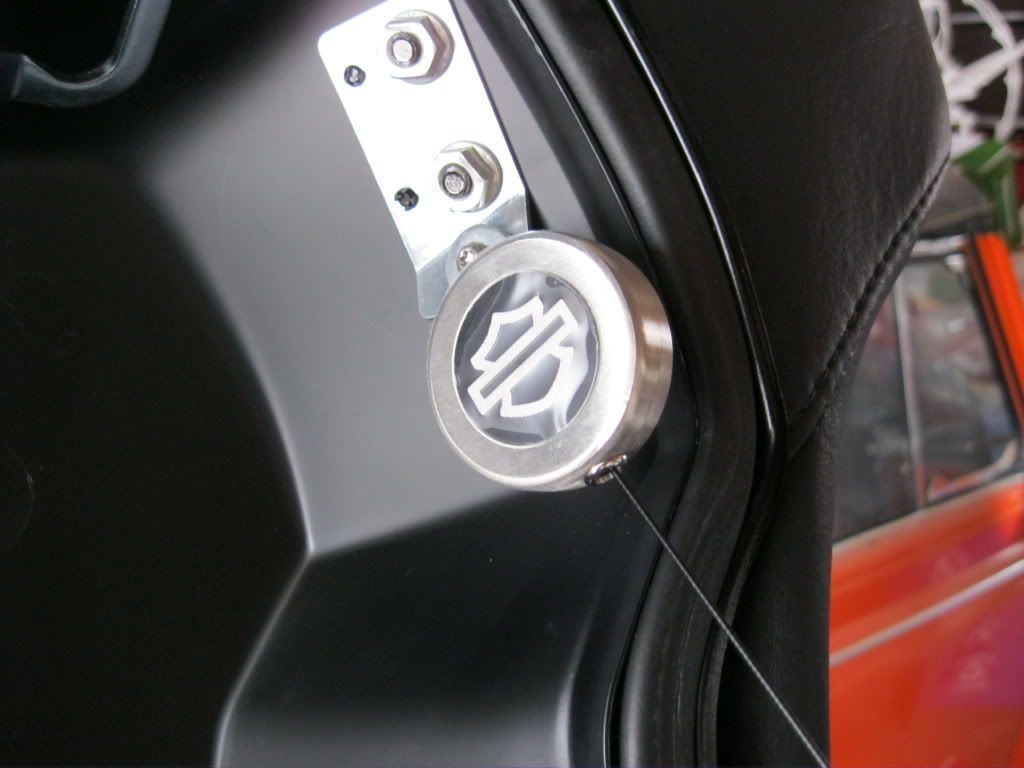

I got tired of the stock cable on my 2012 RGU always getting in the way and hanging out of the pak when it closed and wanted a retractable cable but had read too many stories if the retractable cables breaking. My solution was to buy the newer retractable teather from the Rushmore series. It is a flat nylon cable that at least looks much stronger. It took a little modification to install it but nothing too difficult and it works great. Here is a picture .

i wonder how many failures of the new ones have happened ? some or none ? i have the newer flat one and am thinking of installing alittle extra protection.

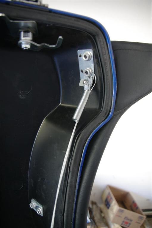

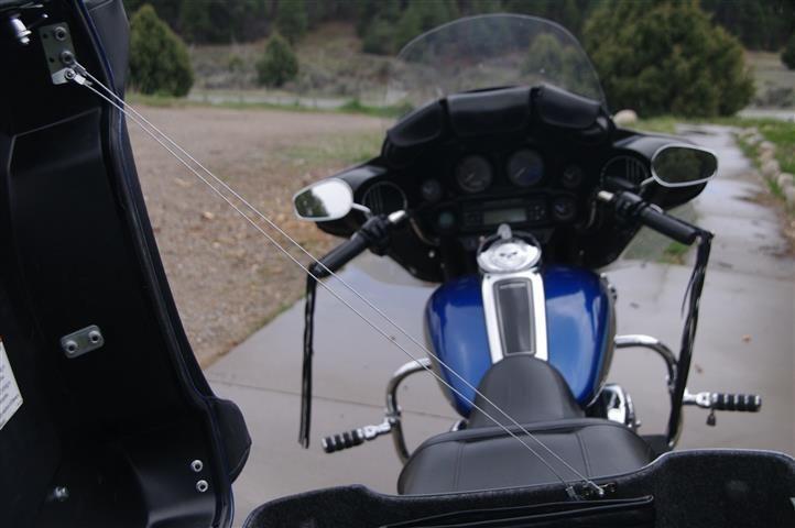

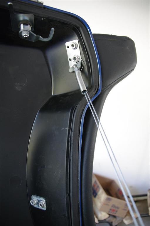

OK so I used two 1/16 inch cables to create my own limiting strap but because of the curve in the Tour Pak each and every time I closed my lid the cable would come outside my Tour Pak and hang out where the passenger would sit. How do the regular tethers work that do not retract?
Closing my Tour Pak became an 2 handed job. That was a pain because the reason I need in my Tour Pak is because my hands are full and I need to put things into (or take them out) of the Tour Pak.
So what I did was go to the automotive store and bought a throttle return spring. I routed the cable through the spring and mounted the spring where one of the cables was mounted.
The spring is light enough that it still lets the Tour Pak open all the way.
The next picture you can see the spring moves the cables out of the way when I close the lid.
