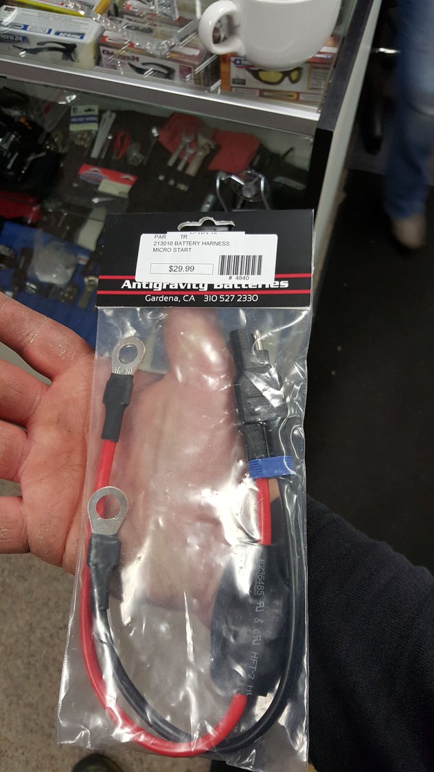

Exactly and they also make a jumping cable that attaches to battery. It just plugs directly into jump pack so no need for clamping to starter or tearing bike apart to get to battery posts. It also comes with an adapter so it can be used as a tender lead.

I got one of those jump boxes like the one Walmart had on clearance a few months ago- cost me around $20.00 (400cca). To get around the PITA of having to pull the seat to jump the bike, I got a harness for the AntiGravity jump box (Amazon, around $25), attached it to the battery and ran it under the right side cover. The harness plugs right into the jump box, and is plenty beefy to run the current. Jump box takes up very little space, and can also power phones, tablets, etc....
