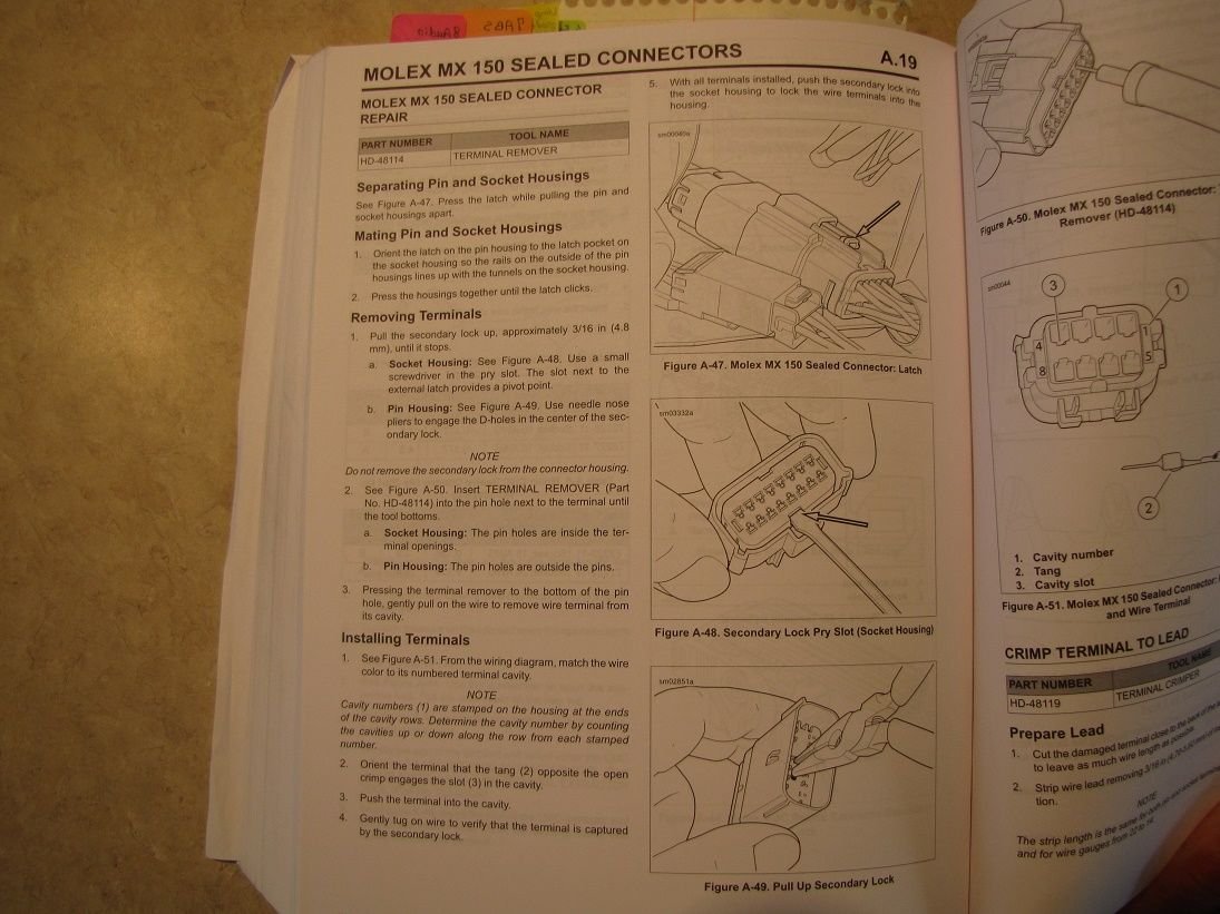

Yes, I know the TT418, but my question was:
How can I
"Replace pins 1, 4, 5 and 6 at the TCA connector 211B (Part No. 72168-07)"?
Which tools do I need?
Has somebody already replaced the pins, or the terminals?
Successful, or not?

Don't know what year you have but here are a few pages from the 2015 EDM

Thank you very much, that will help.
