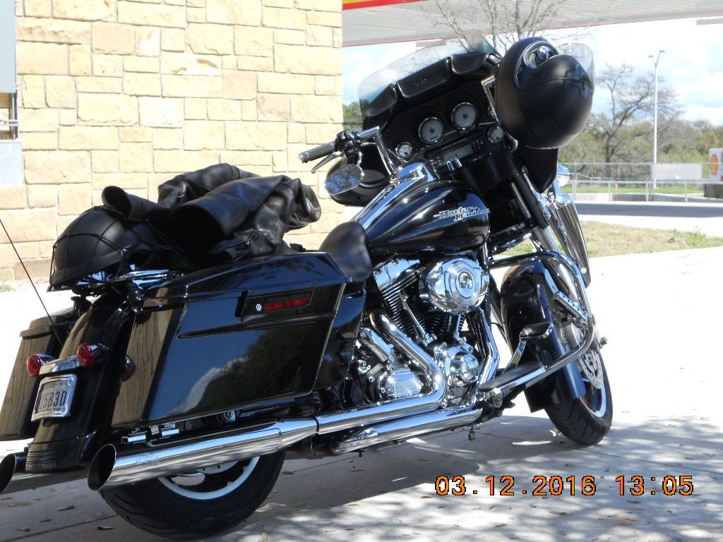

I have the LA Choppers 10" Twin Peaks on mine. Stock cables are fine.
