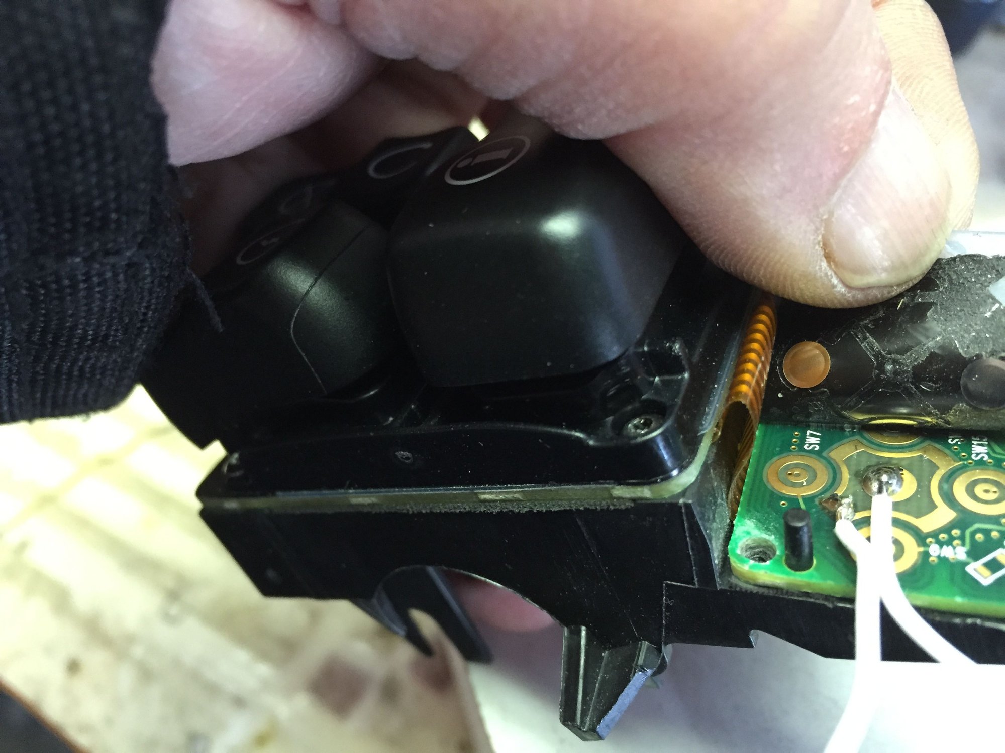

HDean's Avatar
HDean
Posts: 80
From: Santa Ana
Old Mar 5, 2017 | 09:05 PM
dentdave's Avatar
dentdave
Joined: Jan 2017
Posts: 78
Likes: 19
From: South Fl
HDean , can you tell me how this is working out for you and what kind of push button your using and where you mounted it?
Thanks for any input as this might be the solution I'm looking for.
