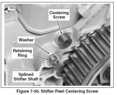

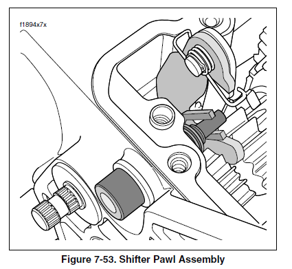

Default pics from a 05 road king manual
maybe the new seal if just stiff and needs to be broke in a little?
or
from what i understand the center screw for the Shifter Cam Assembly plays a part in how easy finding neutral is. this must be adjusted correctly. maybe your mechanic some how screwed up the adjustment when putting your new seal?
or
switching oil can make a difference.
pics are from a 05 road king manual
side view
top of transmission
