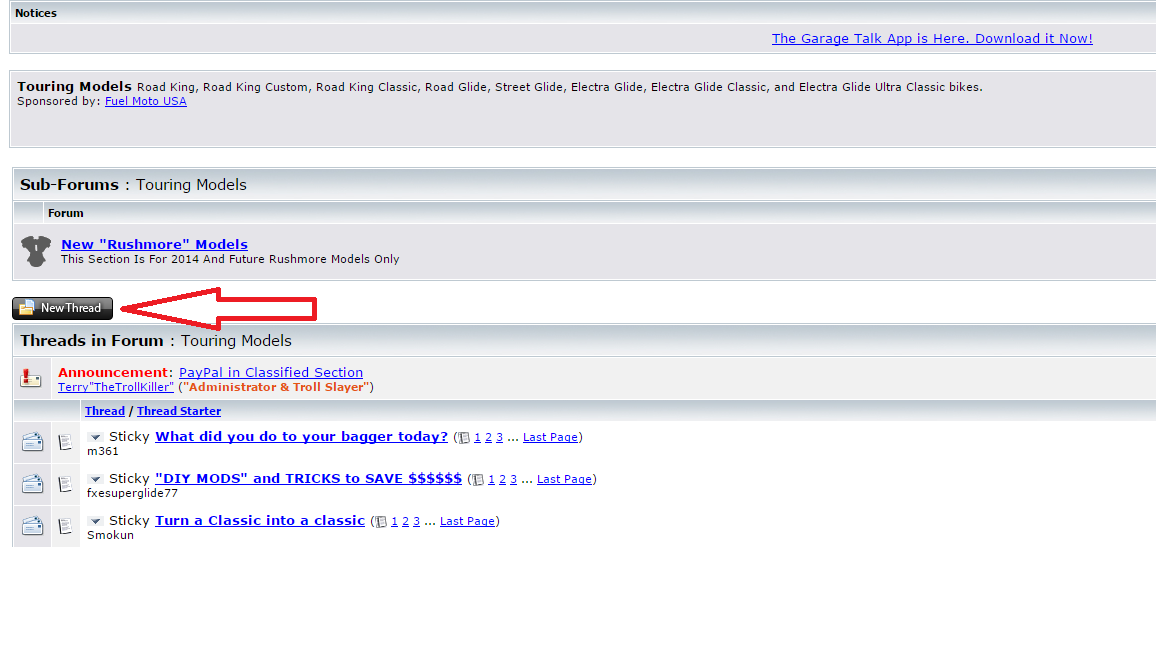

The picture I attached has an arrow pointing to the button you push to start a new post.
