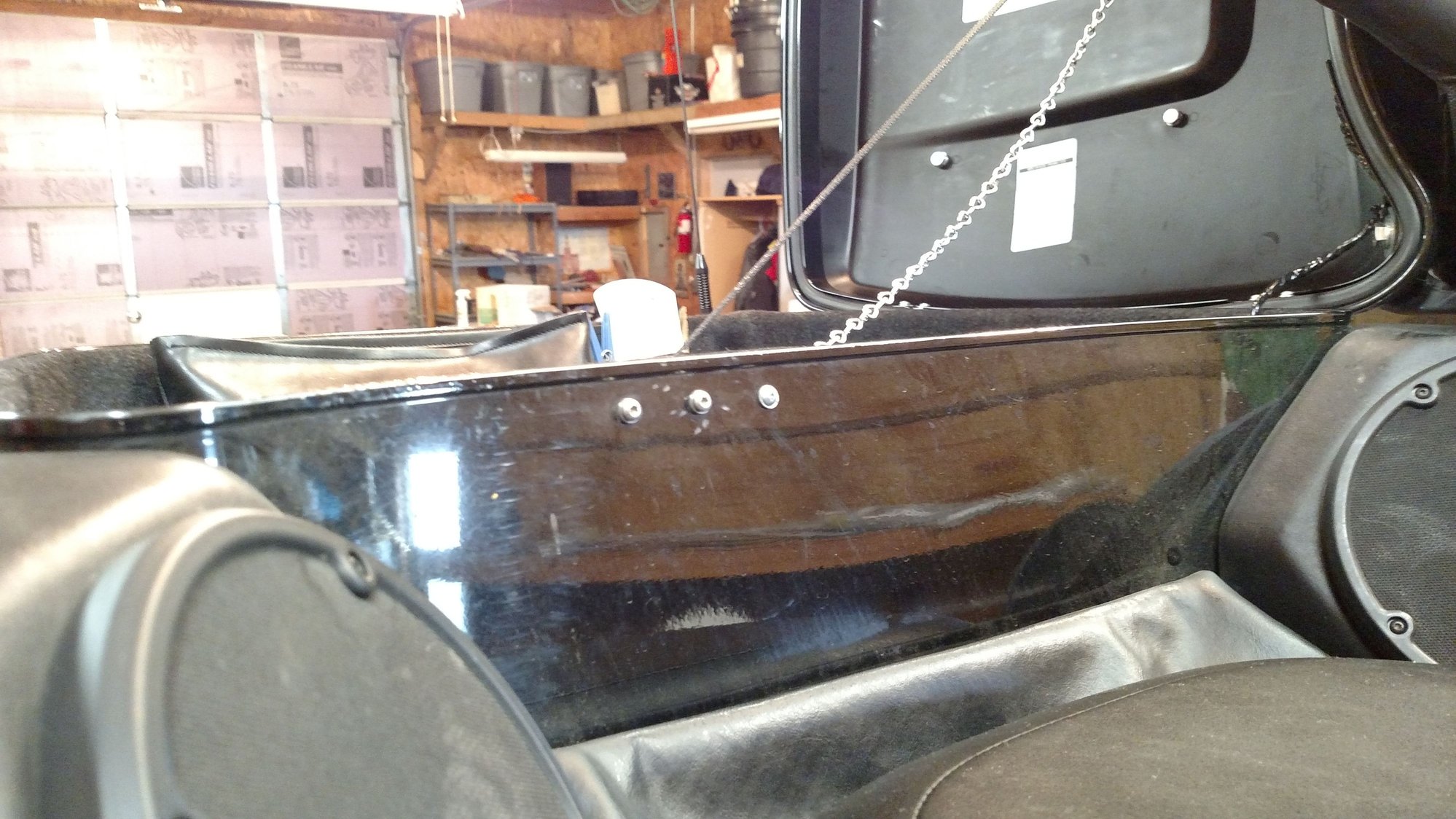

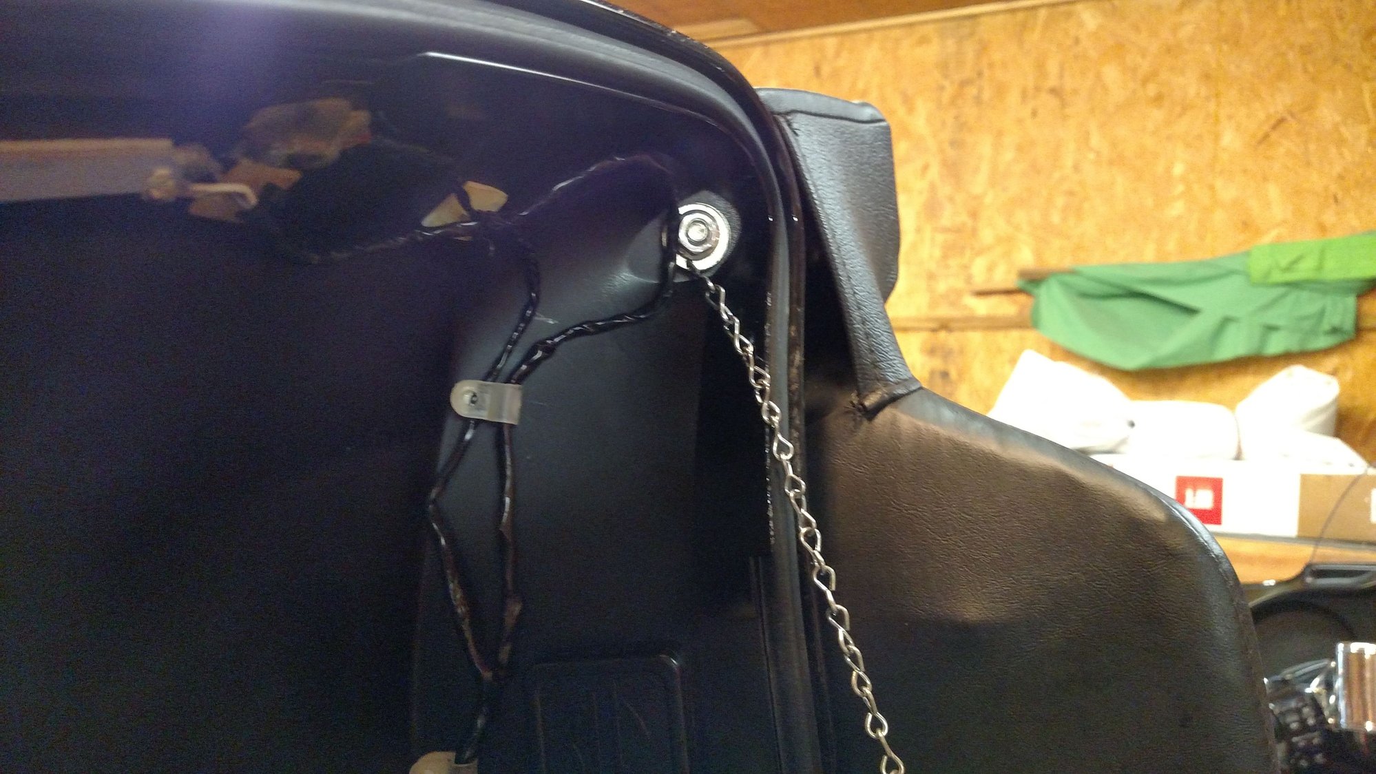

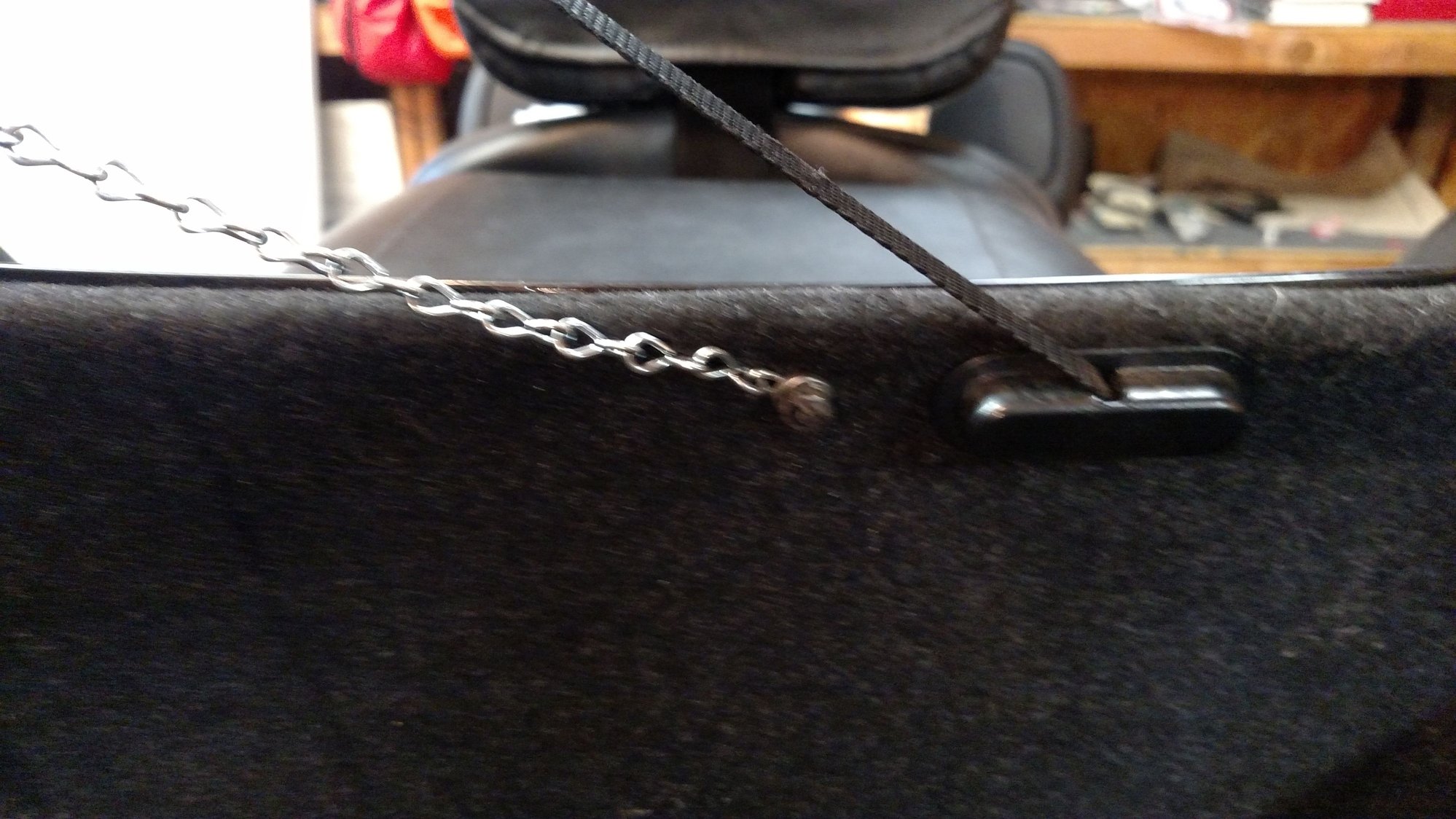

Originally Posted by Boomer1143
I made my own inexpensive support. A couple of cable clamps, some split loom and a short piece of para cord.
The split loom keeps the support inside the tourpak when the lid is closed.
I used a length of chain like the stuff used to hang floruesc...fluroscen...fluors...light fixtures with 8' tubes in 'em. Bolted one end to the nut on the lid that holds on the passenger back rest. Drilled a small hole in the tour pack and through the liner next to the fasteners for the stock retractable tether. Found a SS machine screw similar to those in the retractable thingy and ran in through the hole. Fastened the other end of the chain to it inside. There is just enough slack in the chain that it doesn't bear any weight, but will catch the lid when/if the tether breaks.
