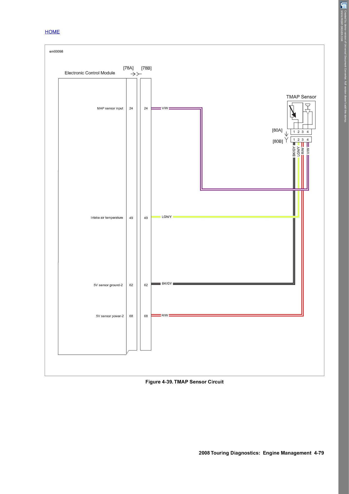

I believe that is the TMAP sensor. (Temperature Manifold Absolute Pressure) sensor.

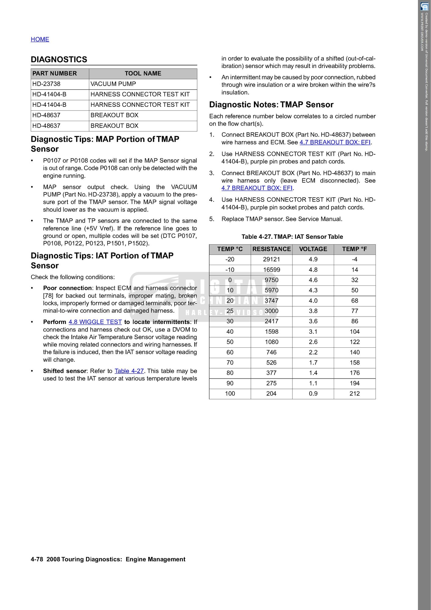

Any chance the check engine light is on?
https://dgcustomcycle.com/tech/harle...es-04-present/

Did you check for DTC's?
