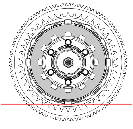

As mentioned, oil level is best when it's about midway up the etching on the engine oil dip stick. If you fill it to the top, no harm done, you just might get a little blow by at the air filter. My rule is I stop at 3 quarts, and start checking. 3.5 usually does it for me.
And don't forget behind the derby cover, bike level, that oil level (Primary) should be like this:
