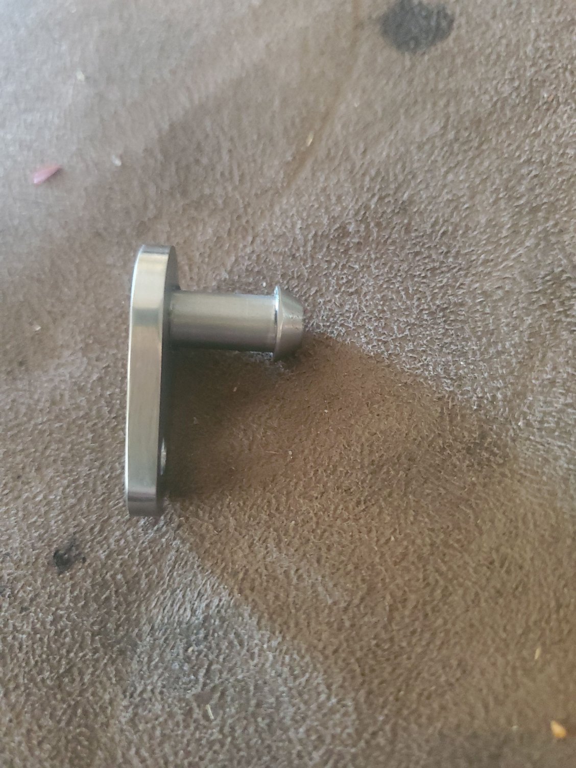

Default Block Off Plug stainless steel for sale.
I sell a custom block off plate that is perfect. If interested email me at dbrodecky@gmail.com..
This shows installed on manifold.
Plug is made of 304 stainless steel 1/8" thick and designed to fit S&S Super E manifold for sure. Dont know how they compare to any others. I would imagine all S&S share the same pattern dimensionally.
You use the same orange rubber plug that the map sensor uses on the pin. The flanged end of the pin holds the orange plug perfectly in place.

not trying to be a dousche but the plug I made is made for the map sensor orange plug. You just remove the orange rubber plug from the MAP sensor, and press it onto the plug I made and the flanged end of the pin keeps the plug from falling into the engine. The pin on my brackets just mimics the hose barb on the MAP sensor. But I agree, the orange rubber plug is the best plug for the hole, and my bracket is the cleanest option for doing so. For 30 bucks, it's a Hella lot better looking than JB weld.
