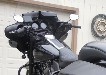

Thanks everybody. Its not a water issue, the Zumo is a motorcycle specific unit. Waterproof. I ran it for 85K on my Victory(s). But, it failed quickly on this bike and it shakes so badly at idle I cant imagine any electronic component would survive a handlebar mounting scheme for long. I ordered another Zumo. I'll put it on the Yamaha and put the old one ((Quest)on the Harley and I'm pretty sure It'll fail. The thing shakes ridiculously at idle and low rpms.
I'll carry maps and use the old Garmin Quest on the Harley until I off-load the bike. Reliable bike but I really dont care for it much.

I'm using a cheapie prepaid cell phone (moto E LTE, $40 at walmart with no contract) and use the wireless hotspot feature of my regular phone to get data service to it.
Built a mount for the Harley fairing GPS mount (came with my bike - GPS unit did not) out of a cheap case and a Garmin weather cover. Total investment was around $60.
Only been running it since July I think (4k miles or so) but so far so good...

Returning to your first post, Harleys shake, they don't vibrate! If your bike shakes as you describe there may be something wrong, such as a failed or failing engine rubber mount, which is worth checking. I don't use Garmin products, but they are built to survive the exact same conditions that all the stock electronics on your bike are happy working with. So it should be fine!

You happen to have apes? The taller the handlebars, the more their ends flap, especially at idle. Might also want to checkout motor mounts, particularly the front. Broken or an overly hard replacement one can make the bike shake quite severely.
