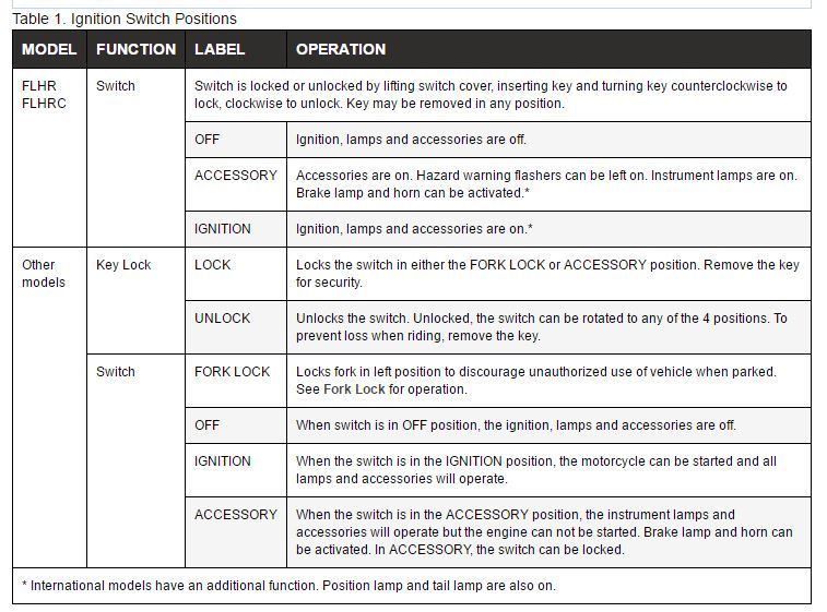

I'm kinda on the fence about taking it in for the diagnostics tomorrow. I doubt anything is wrong with it. I'd read early this week the international models were set for both front and rear light to come on in accessory mode. Paying them $50+ to plug it in a computer and doing 30 seconds work switching something is nuts.

I kept the appointment with the dealership.
They checked the electrical system, and said the rear lights should come on in accessory mode, but someone at the factory or the previous owner may have requested the front lights also coming on.
They set it up so now in accessory only the tunes, power ports, and emergency flashers work.
Got there around 2:00 and was riding out by 2:45. Had to wait an extra 15 minuets for them to wash the bike. So I got my problem fixed, a clean bike and the price was zero. Bike's warranty ran out last April. I like stuff that's CooL!

According to the manual, the headlights will not come on with the accessory for US models. They will, however, come on for some international models. (See the asterisk note on the picture.)
I saw that in the book that came with my bike. During a google search I found a lot of peoples rear lights came on with accessory.
No clue, just glad it's OK and set up the way I wanted it.
