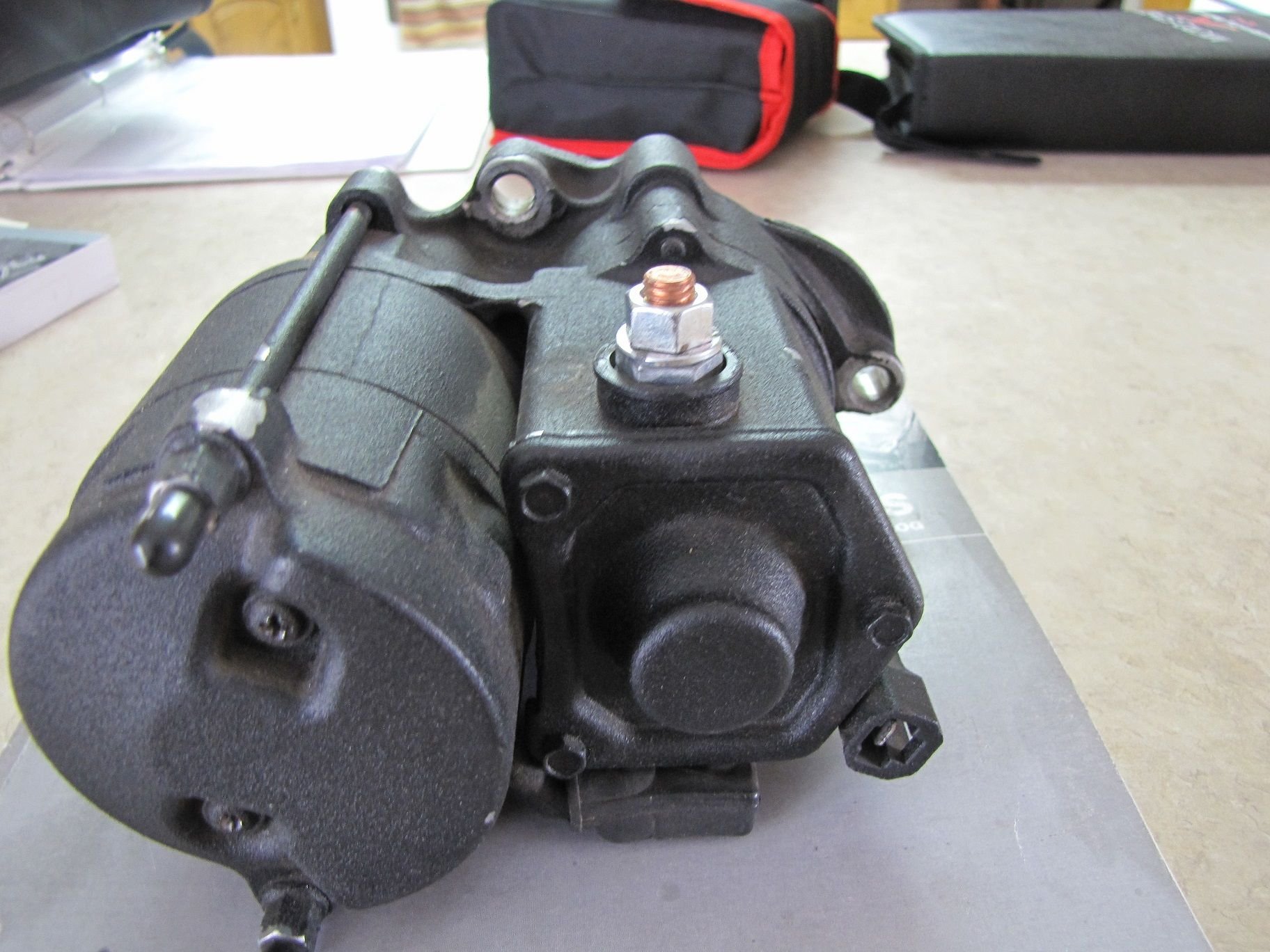

Just hook to the positive lead on the starter and ground to the frame. No need to even take the seat off.

I carry a small jump starter, and a small set of Yuosa jumper cables.
Connect to hot post on starter and a grounded bolt.
Go ahead, get familiar with the starter hot post under the rubber boot, it might come in handy some day.

Originally Posted by Vernal
Geez ... If you take the starter off to hook up the jumpers, doesn't it make it harder to put the starter back in? :>)
Not if you have a flex head ratchet and he proper number of universal joints
