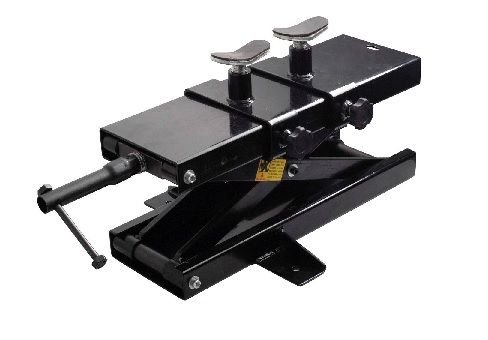

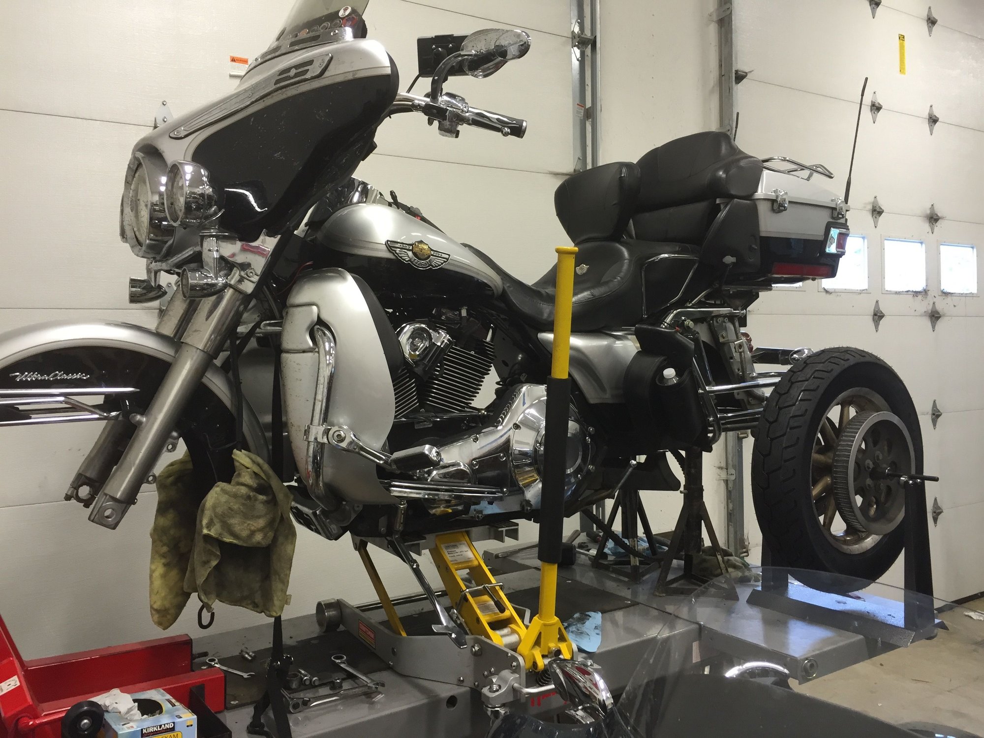

I have both. A Handy electric table lift and a motorcycle jack. I also use a table lift jack to raise the rear tire off the table.
They are also awesome for just pulling the front tire to work on it or the front end.
I block the rear tire and have it in gear, and place the jack under the front portion of the frame and up it goes. Won't roll off as it is blocked and in gear.
Just don't be too stupid, as it is a balancing act, and things can always go south on you. Been doing this on my ultra for nearly 8 years working on it and good results each time.
It is really nice putting the front wheel back on as you can really lower it slowly to align the speedo drive/axle/lower leg all together.
One of these really are work horses if you have a table lift..
