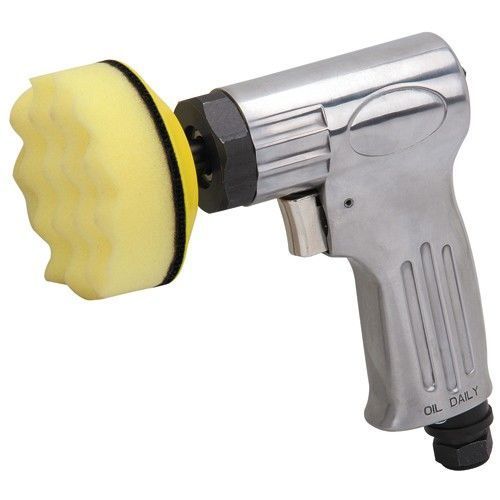

I'm a novice in the detailing world so you have to be patient. What is a DA? If it will help, I will find the money to get one.
As I stated earlier I have both of these, are they considered DAs?
Are the 4 inch pads made of foam you speak of like on the pneumatic one below?

DA has dual action. it goes in a big circle and then sort of a small one inside the big one. Hard to put it in word. The drill would NOT be a DA. They do make air powered DAs for body work. Don't know if that is one of them. They do not spin fast enough or have enough power on certain angles though
