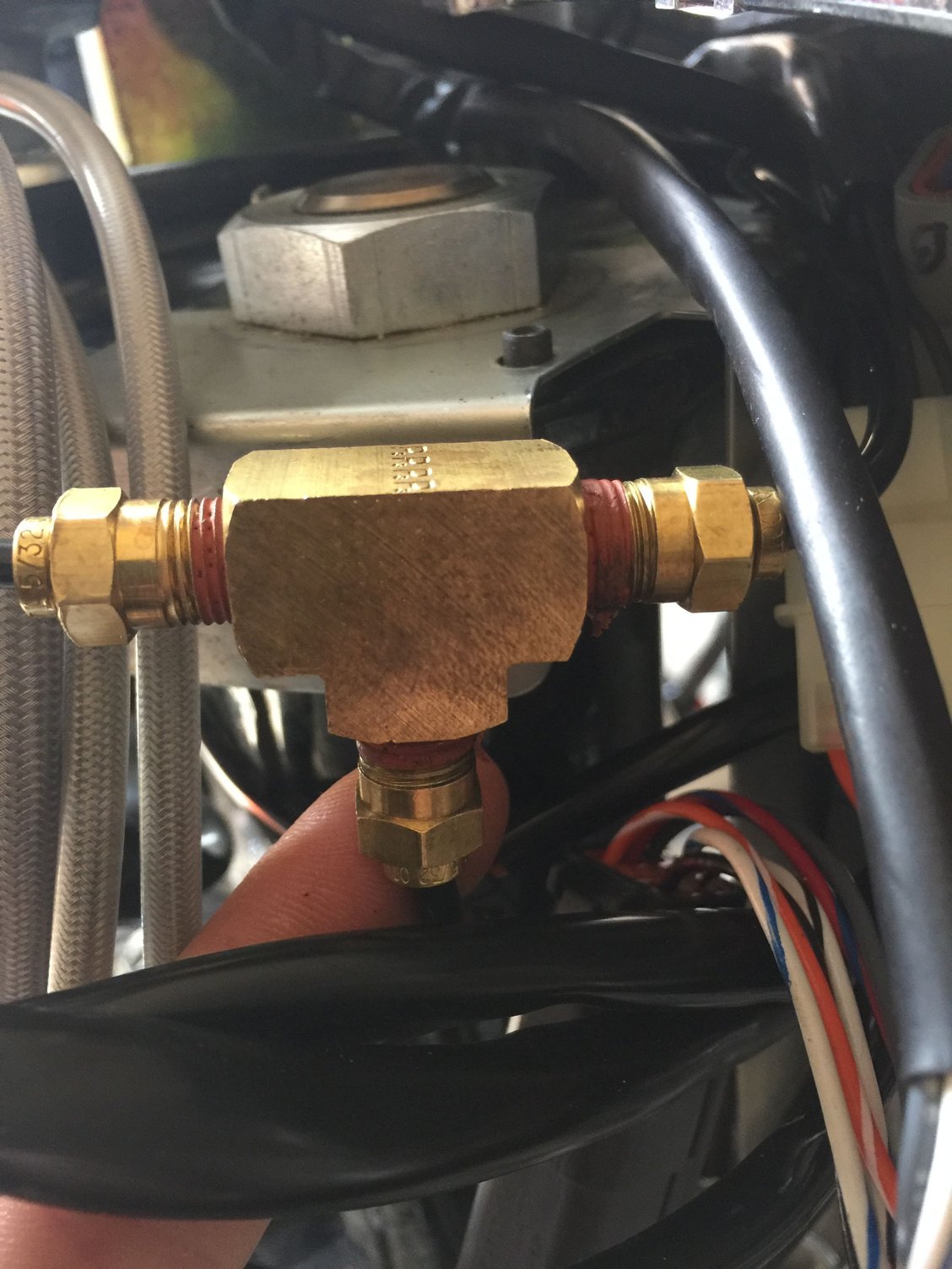

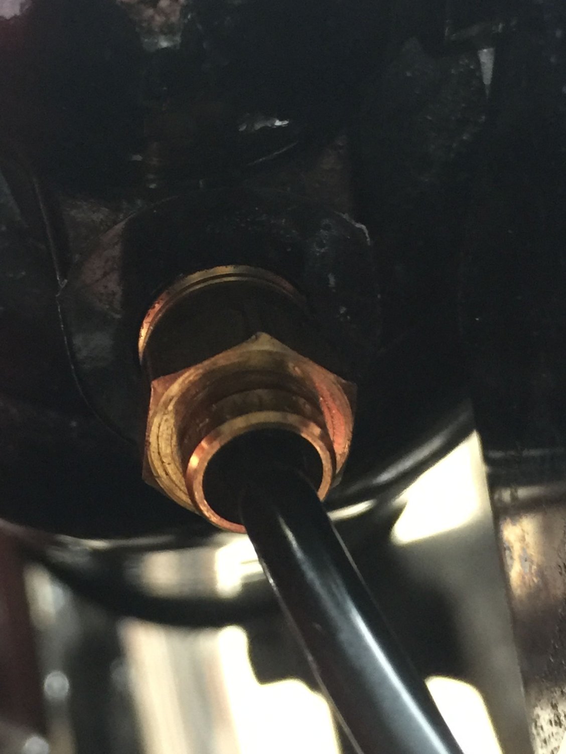

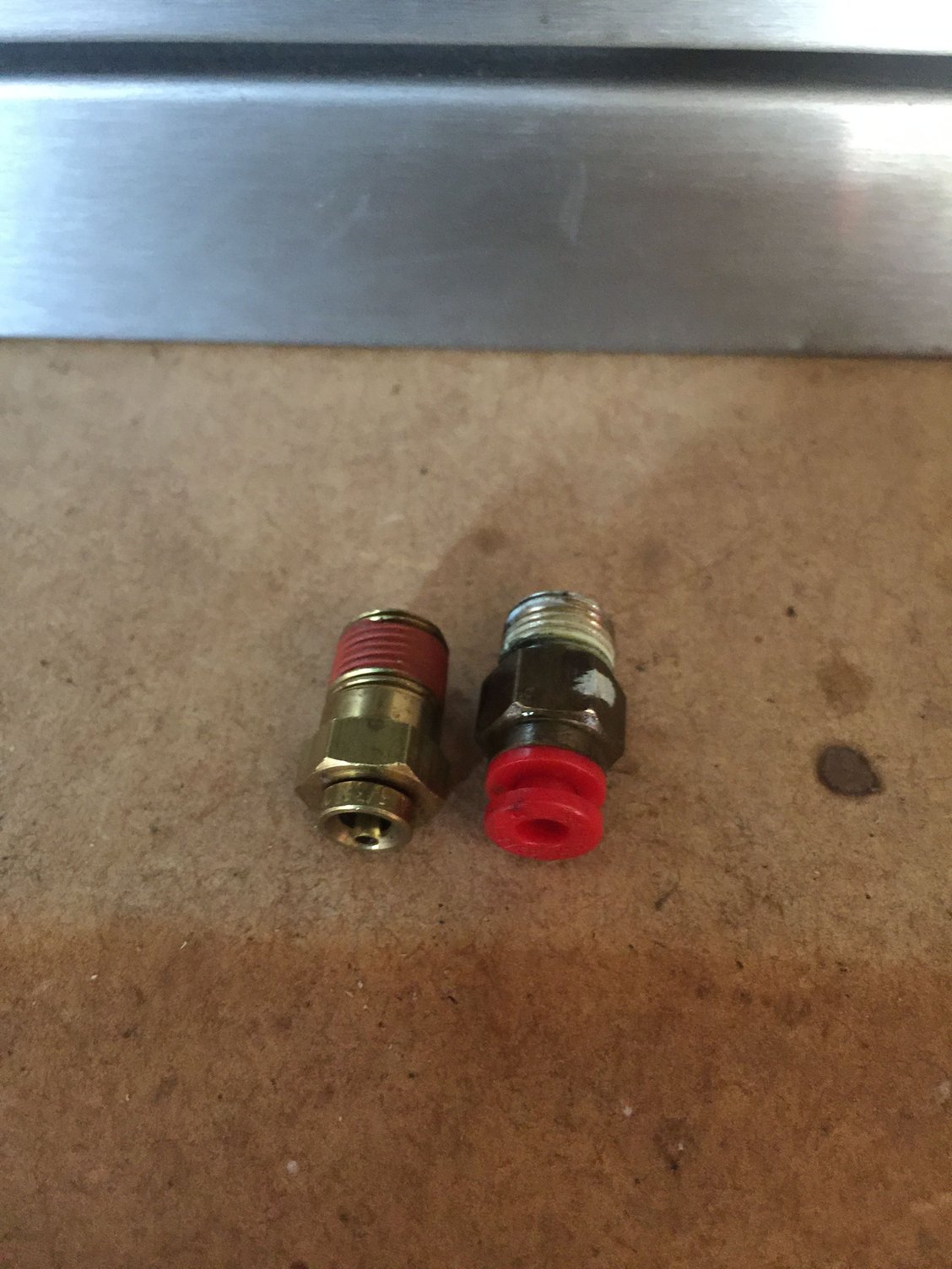

OP, I know this only partially applies to your case since you have an aftermarket system, but check/replace fittings if the airlines are good.
FWIW I fixed all my air leaks today and life is good again
All my lines were good.
I was loosing air almost instantly in the front. One of the fittings was broken on the plastic T and it was not holding the line in place. I replaced it with a metal t with new fittings that can be individually changed if needed.
Next was the left side shock leaking at the fitting. I pulled the line out and cut it straight. Still leaked. Replaced the fitting and no more leaks. I went ahead and replaced both fittings at the shocks.
4 hrs later and the pressure is holding perfectly. I also fixed a slow leak at the reservoir tank for the seat.
Hope the system will hold out for the 2017 season.
The fittings can be had online very cheap, 1/8" NPT and the line is 5/32 OD
I bought it all at a local hydraulic pump and hose shop.

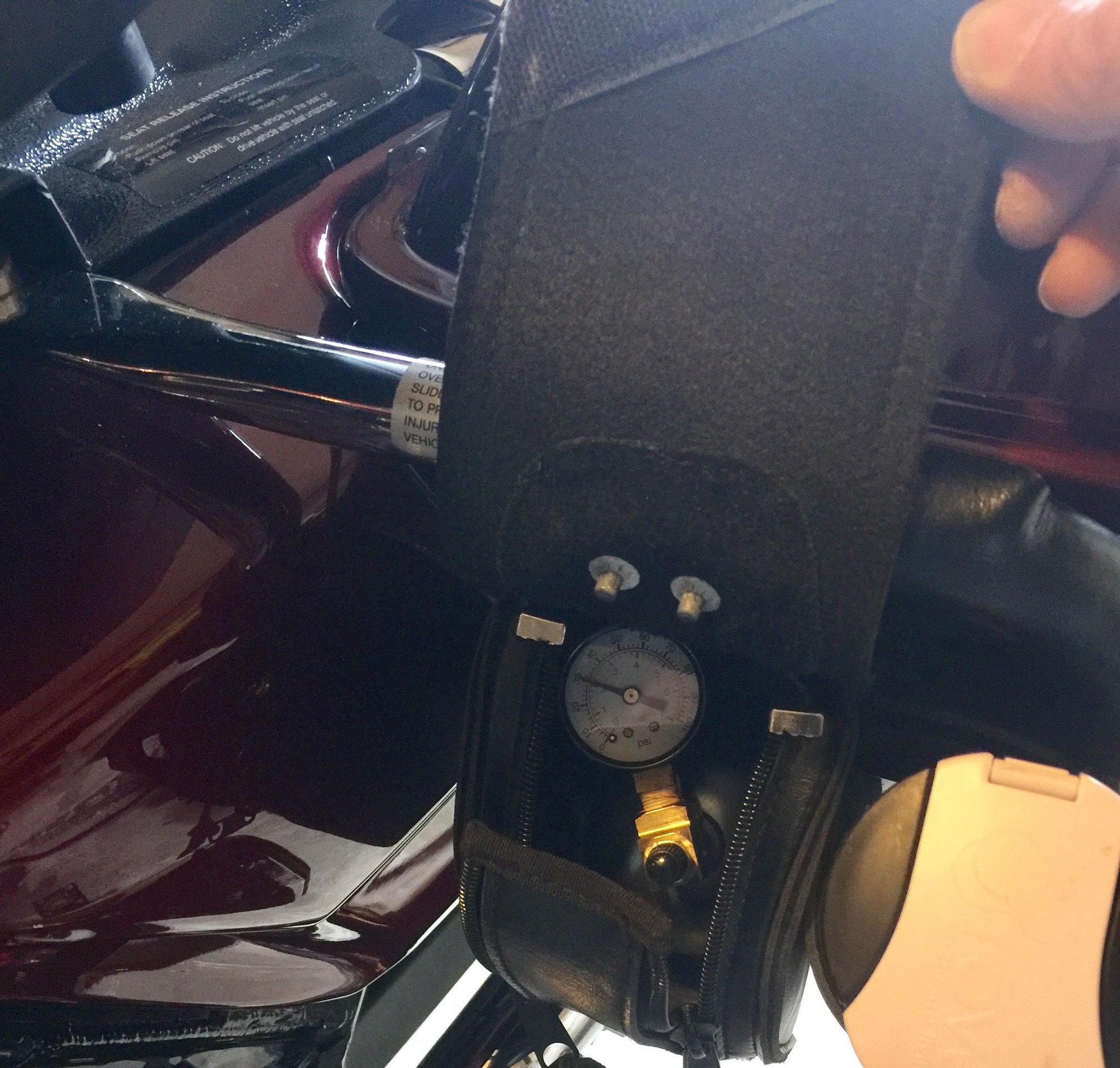

Originally Posted by jeeper101
im digging this air gauge mount setup , did you make it or buy it????
DETAILS PLEASE!!!!
DETAILS PLEASE!!!!
That is just the police seat air reservoir. I normally don't use the small crash bar bag so I cut the bracket and stuck it in there.
However, there really is nothing to it, just a T, the valve and a 1.5" 100psi gauge. You could buy the gauge from eBay for about $8, the brass tee is about $3 and the valve is $5
yeah that's what im thinking, I have a bag and only the bottle holder gets used so I could put it in there
