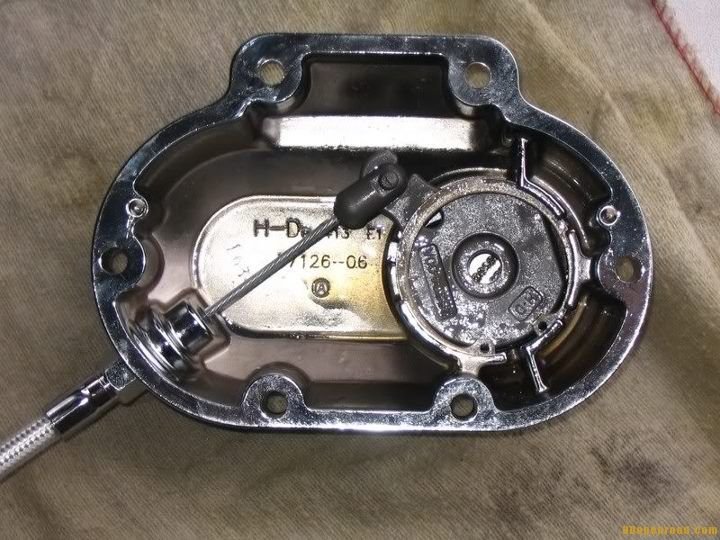

YEA.. YOU definitely do not have to remove the side cover if you were just changing levers...is the cable routing any different? i just replaced my side cover...the cable sits up high like in that pic... not really any slack adjustment there that i could see...did you verify that the need cable was indeed longer?

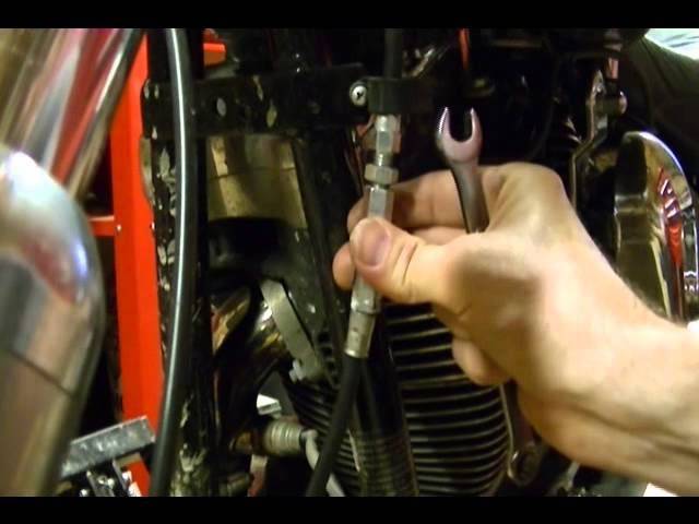

Turns out I just had to adjust the clutch under the derby cover.
Hills Customs had the answer.
