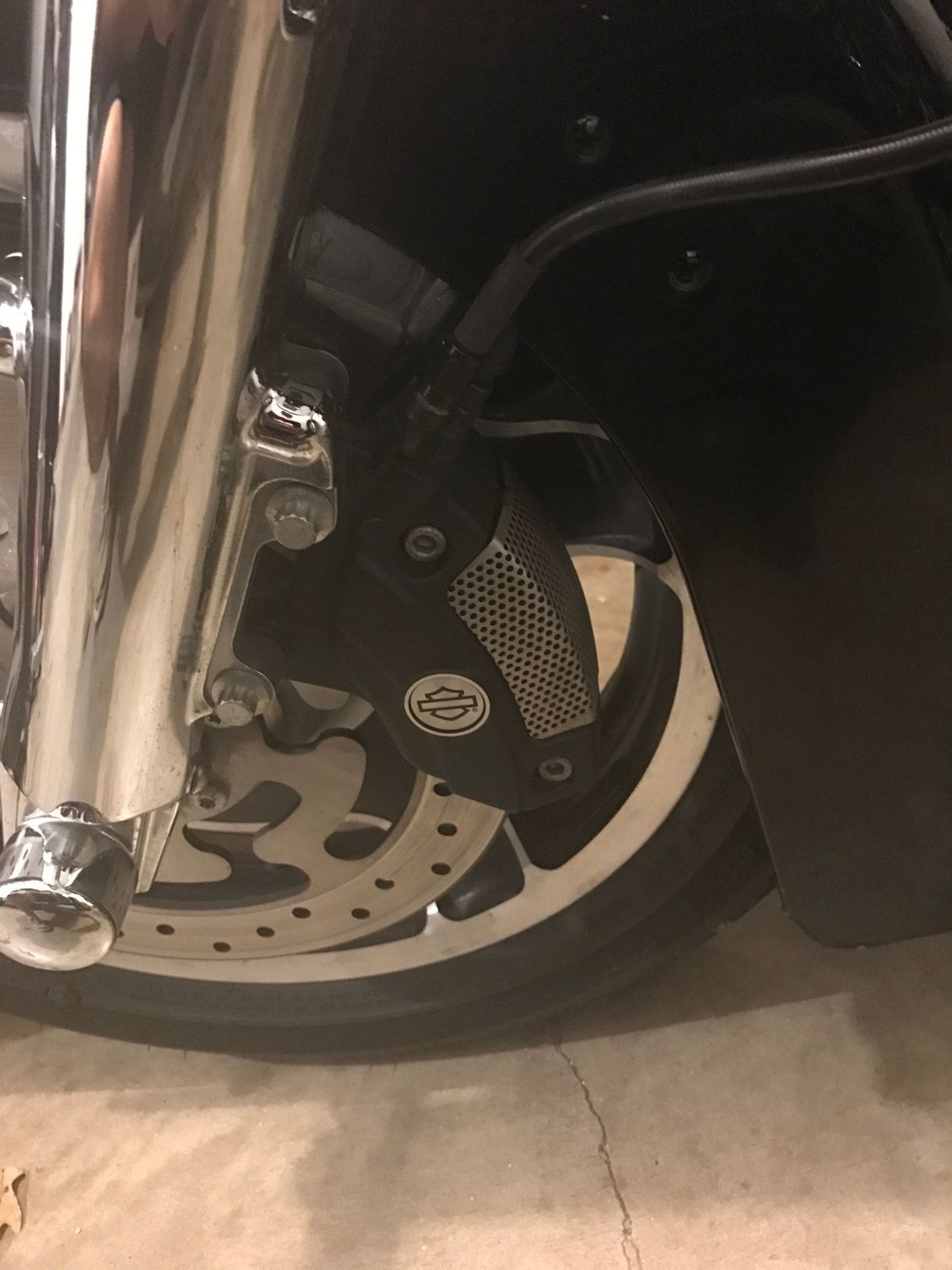

Okay this may seam like a crazy question but I just bought an 09 SG and I don't know if it has abs or not. The gauge has a display for it but it never lights up when you initially turn it on. I really don't want to cram on the brakes to figure it out. Is there a sure way of telling?

Could be, Harley started putting abs on civilian tourers in 2008. The abs system should test itself on start (the abs light comes on and then goes out once you start moving if the system is working properly).
Look on the left side of the front wheel hub. If it has a black band, it has ABS. Also, there should be a sensor wire running down to the front wheel hub alongside the left brakeline.

No wires on either side so I'm guessing no abs

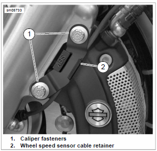

It doesn't look like it. If you had ABS, you would see this

Nope, bummer...
