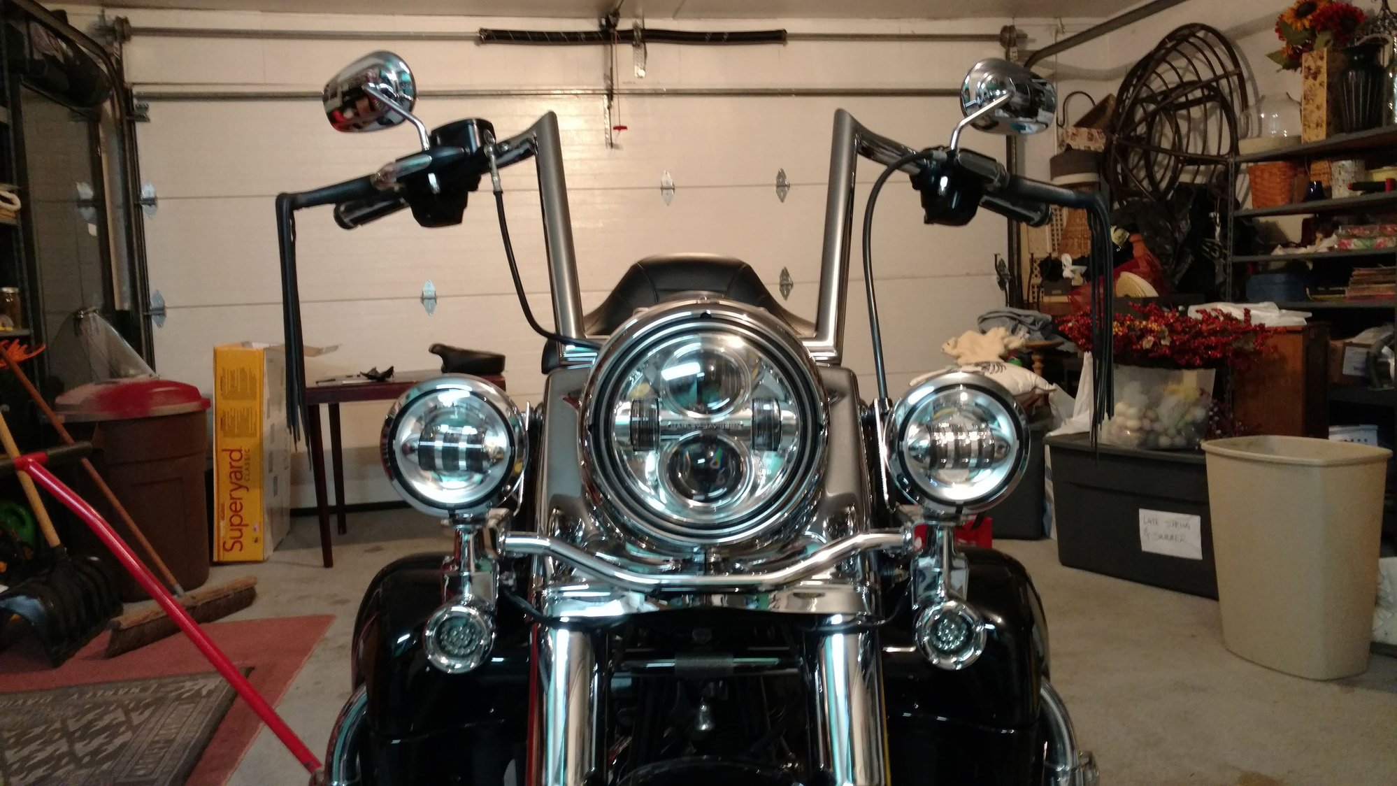

Just finished the reapers on my RK and with Heated grips. These are 12" and Wild! said I wouldn't need any extentions. I did a write up a couple weeks ago. Apparently on RK, you need switch extensions. Got the bars off ebay for $250 shipped, and Namz 8 in extensions from Hillcountry for $32. Did the work myself after watching a few youtube videos. Wasn't hard. read the write up.
