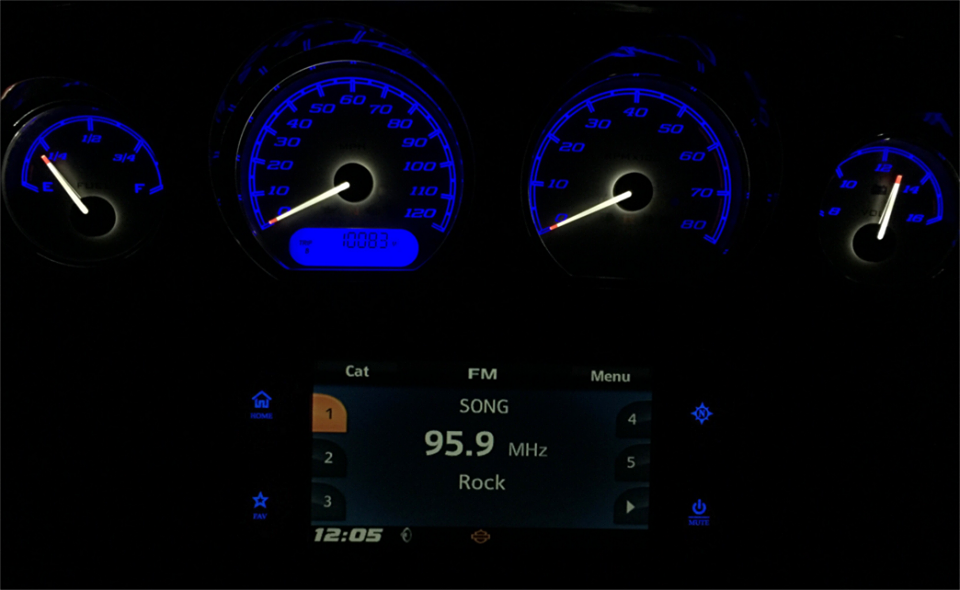

The gauge bulbs are easy and cheap to do yourself. Just pull the bulb and replace with LED, color of your choice. Personally I'm puzzled by the notion that they are too bright and need to be turned down. I have swapped mine out for blue, and they show fine at night, but the light is pretty low, hard to see that they are on when it is dusk.
The speedo and tachometer lights are soldered to a circuit board and very difficult to do yourself if you dont have a lot of experience.
As mentioned there are plenty of folks that do these well, and for a modest fee.
