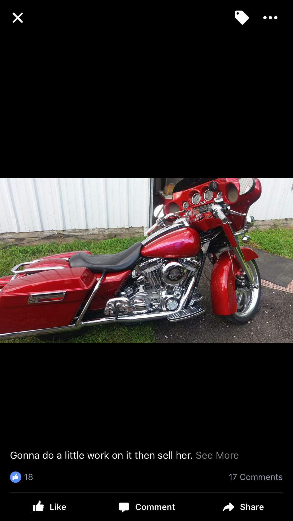

A little hard to see, but that wheel doesn't look like it has any provisions for a Right-side Rotor...that means a different wheel will be needed. How wide is that tire...looks a little skinny
The bike was designed for dual front brakes. Having only 1 rotor or converting/keeping your bike to a single caliper will provide suboptimal braking. Remember, front brakes provide most of the braking. Do it right. You will likely need a new wheel.
